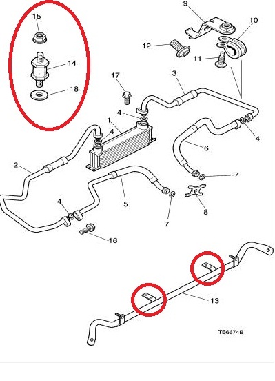

The oil cooler mounts on a bar that runs across the front of the car. When someone noses it into a parking block or steep entry the cooler can get banged up and the tabs on the bracket bent. The rubber mounting bolts can get damaged too.
I did this fix about a week ago. Took the cooler loose, bent the tabs back to strait and replaced all 4 of the rubber bolts. $10 in parts and about 30 minutes.

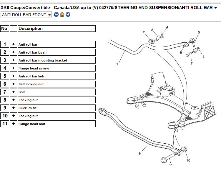

Originally Posted by Jag Vroom
........ the "bar by the oil cooler was bent fairly bad some time ago" I get my car back tomorrow, but was wondering if anybody ever heard of this or even knows what "bar" she is referring to?...
Matching this description, across the front near the Oil Cooler is the Anti Roll Bar (item 1) and the Fulcrum Tie (item 9):
Of these, the Fulcrum Tie is probably more vulnerable to damage if the vehicle is bottomed.
Attached Thumbnails Bent bar near oil cooler?? Any ideas-xk8-anti-roll-bar.jpg

I would of thought it was the mounting bar the cooler is fixed to like Charlie shows..... Not a light weight piece of tubing either, must of taken quite a bang to bend it!
