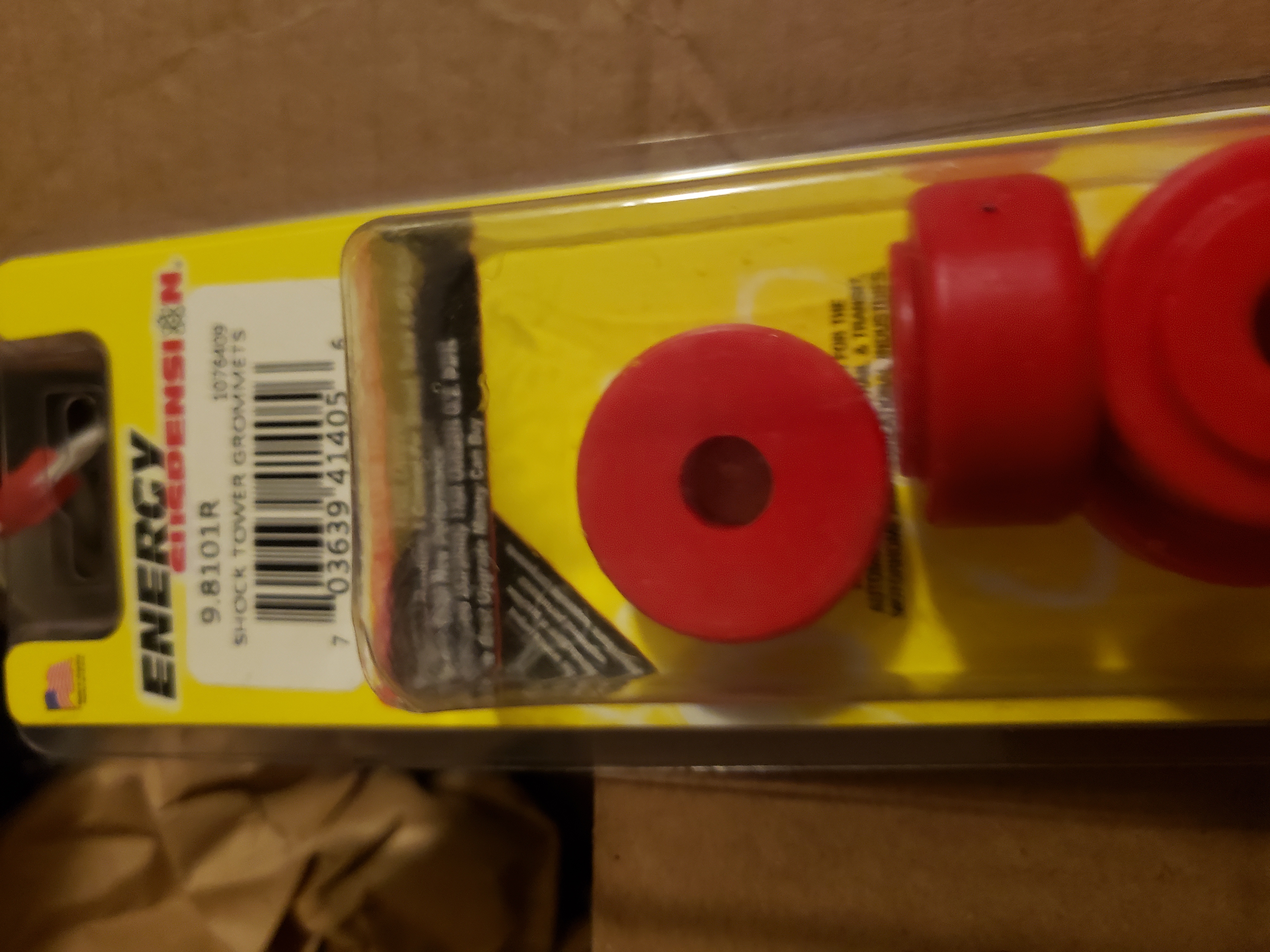

Z, I replaced my front sway bushes with poly bushings. I don't recall any noticeable difference.
Otoh, lets talk about rear link bushings. I purchased polyflex replacements. Expensive, they flattened out in about a year. Decided to try an experiment. I had a bunch of Energy brand bushes (I will post a photo). They too are poly, cost a small fraction of polyflex' price.
I did find the hole inside is a bit too small - no problem. Grab a pair of vice grips, lock it in, put a drill bit on your drill . . . Seconds later, perfect sized hole. Now, these made a difference, a surprisingly big difference and they last for years.
I'll come back with photo that includes model# info.

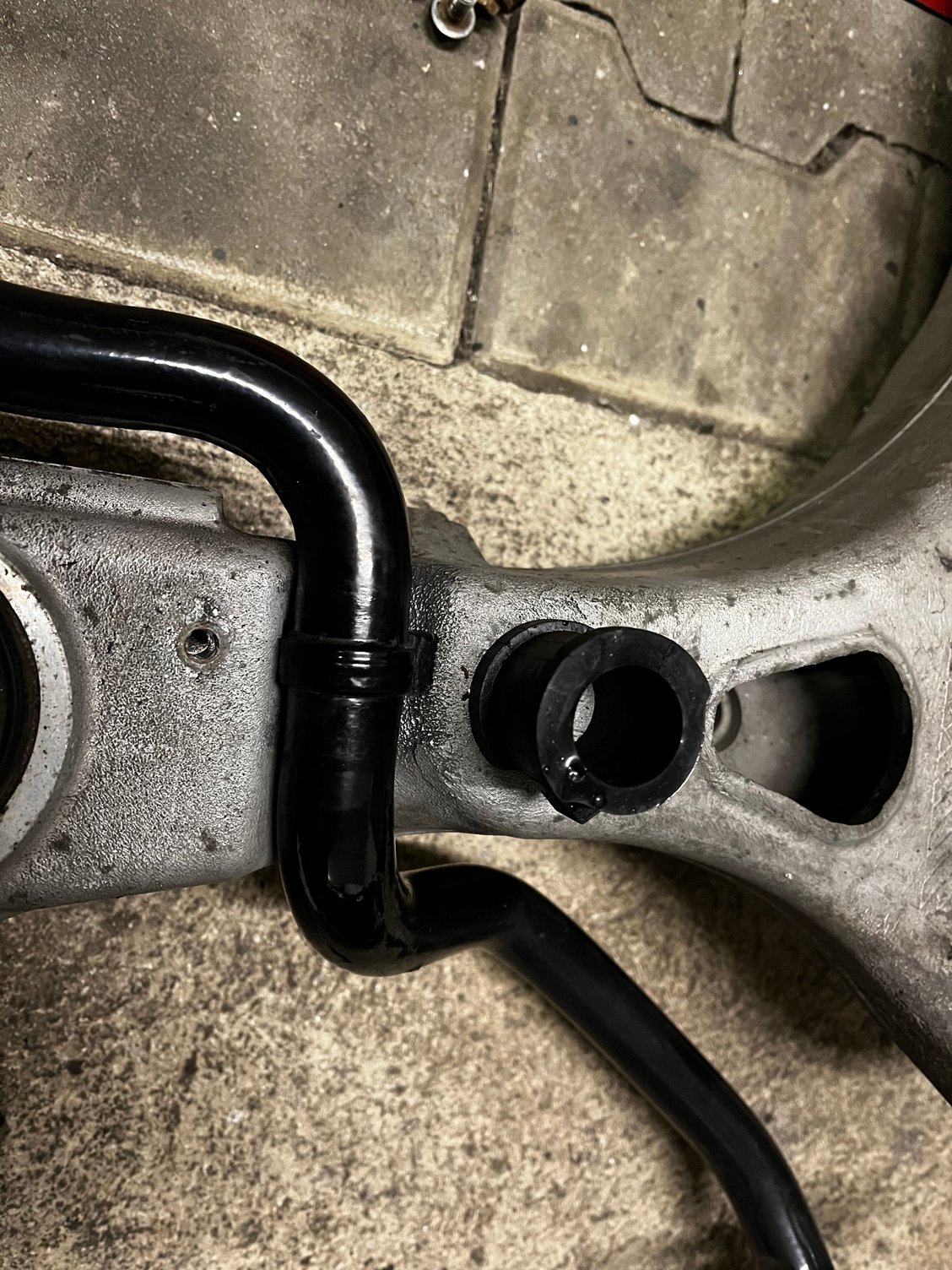

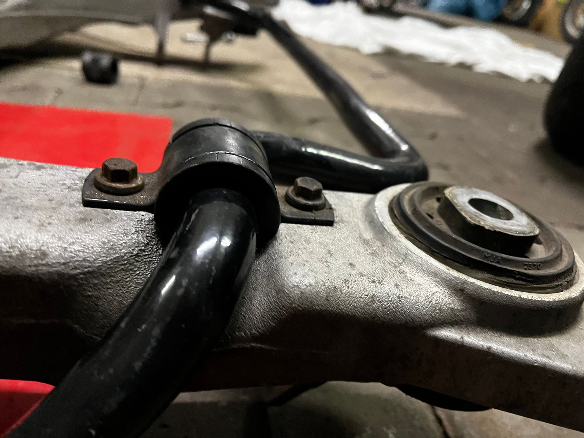

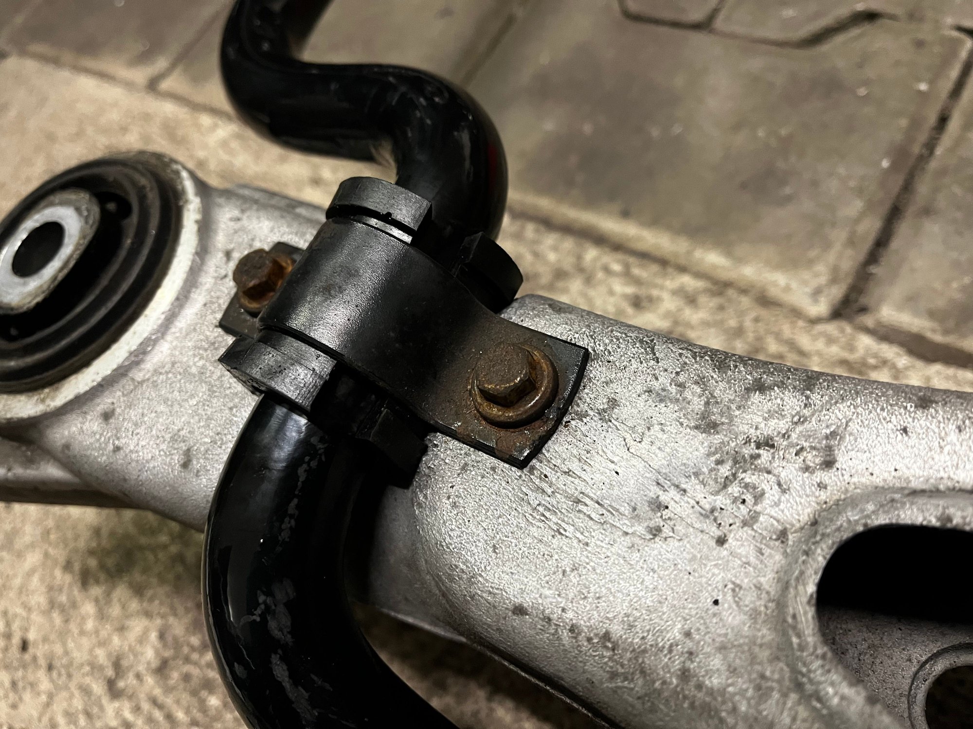

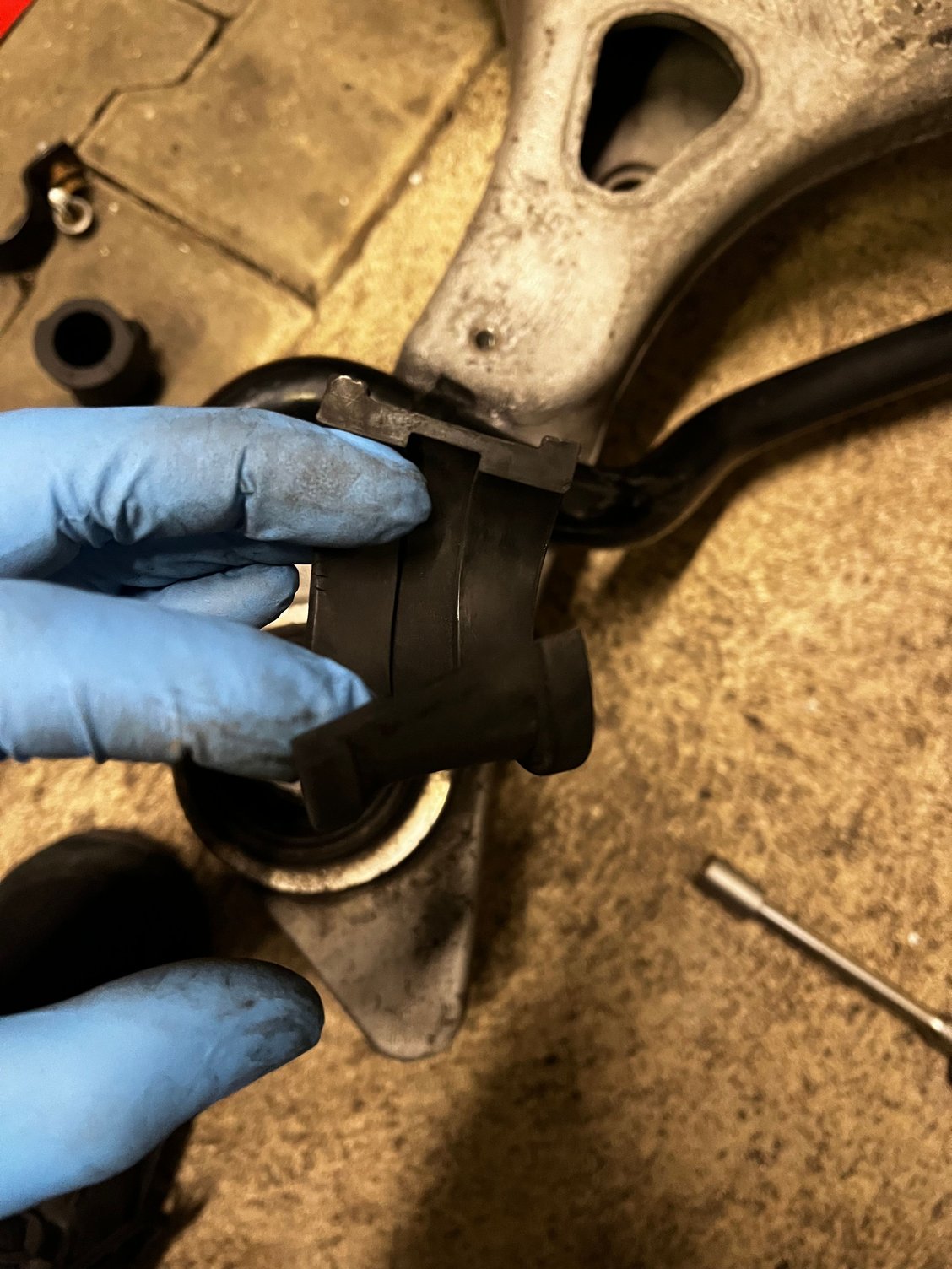

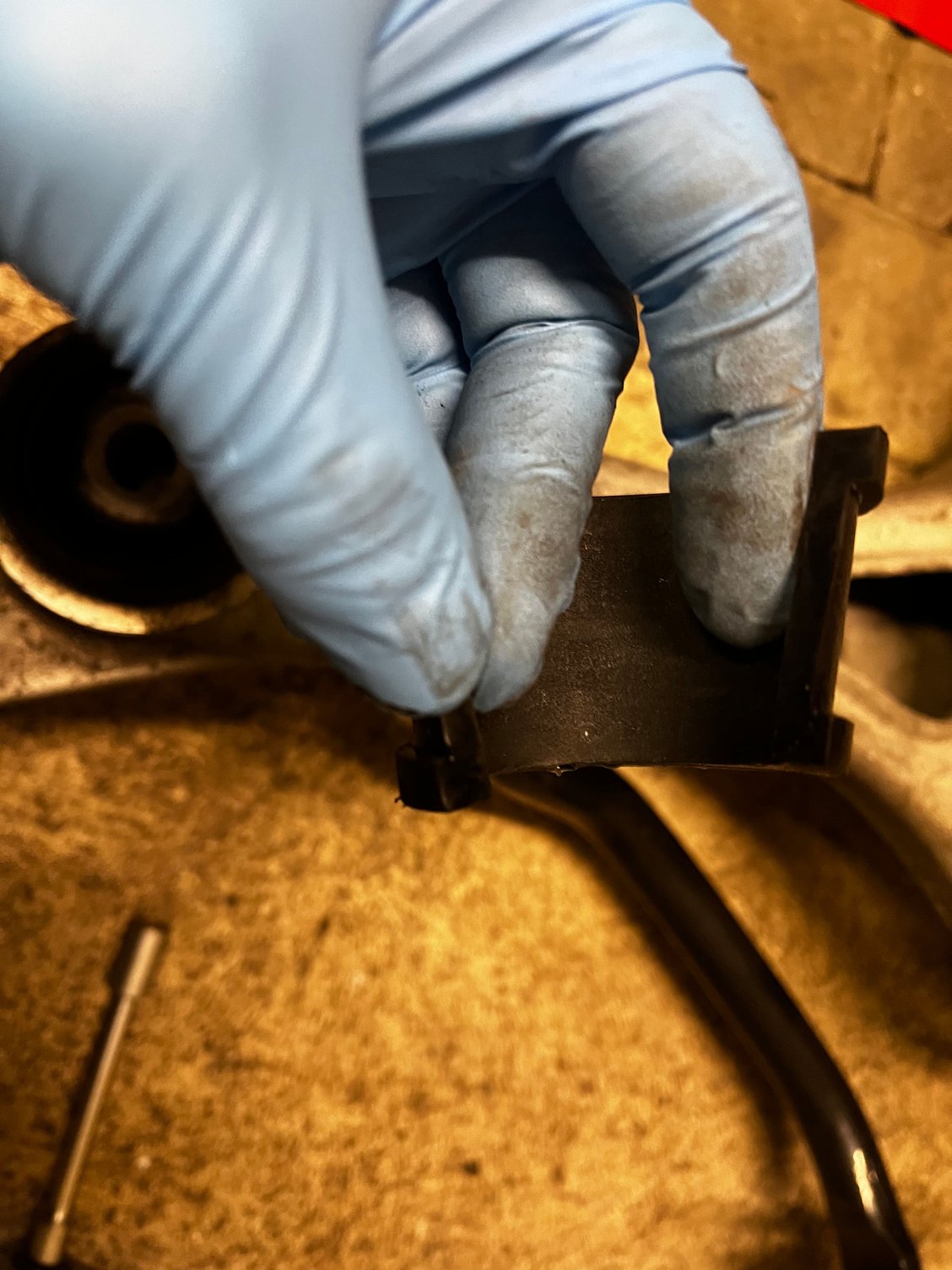

you have to watch out if you have a XK8 with the newer sway bar. Powerflex (or Polybush) for example doesnt provide the right bushings for the new bars.
The old sway bars had (sometimes^^) a plastic sleeve which you can take of. the newer sway bar with the 4.2L has the same on one side but its part of the metal.
