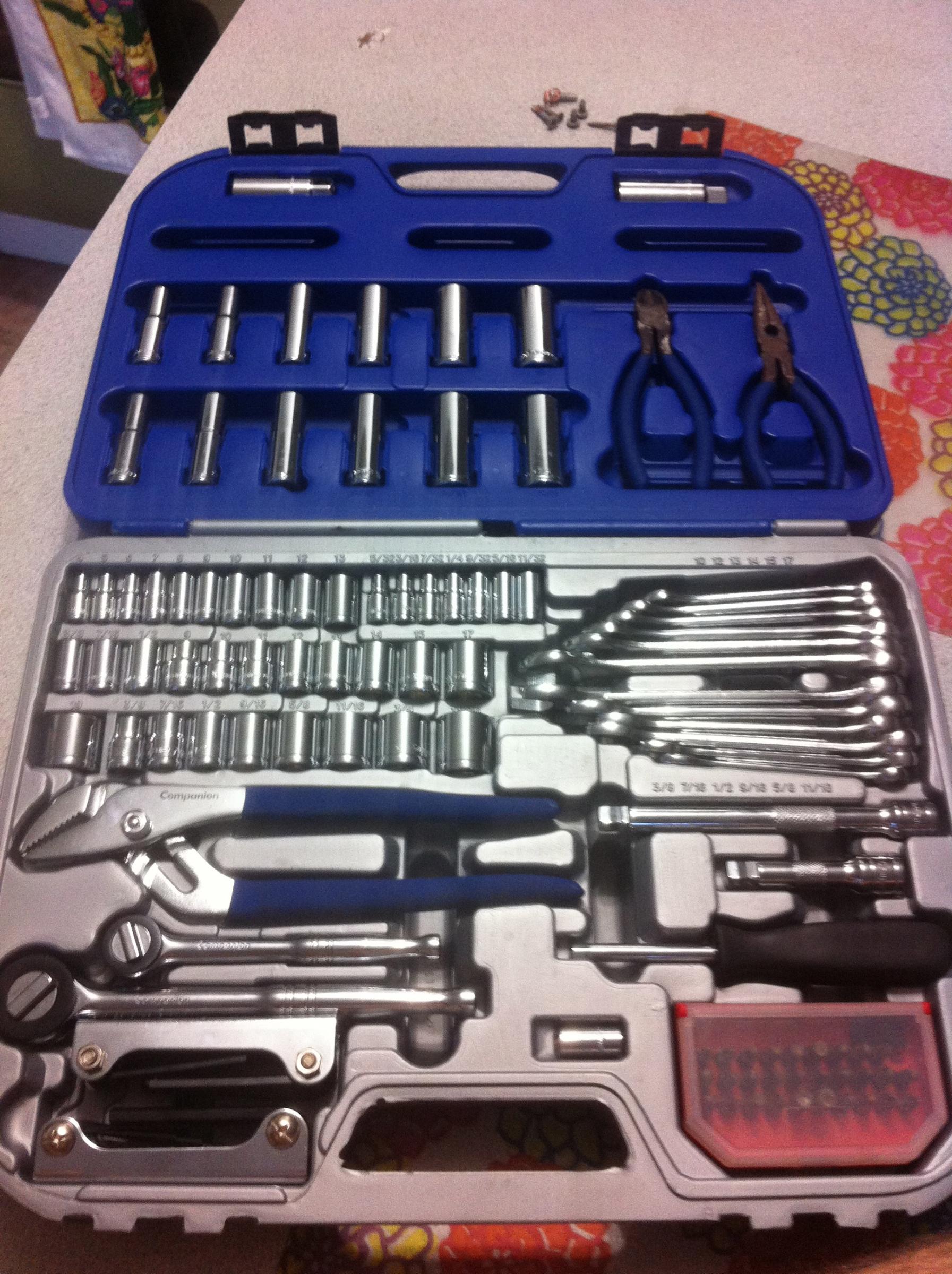

Well, I feel like you guys are speaking in Chinese to me. I know all my tool names in spanish, but I'm a little lost when it comes to English names. I'll include a picture of the toolkit my uncle gave me, let me know if I need something that isn't in there.
Now about the bolts, could someone point me to the correct bolts I should buy? I'm also having a little trouble locating the pdf for the zip-tie method.

Old Mar 1, 2013 | 04:54 PM
Posts: 121,143
Likes: 6,654
Try this one.
https://www.jaguarforums.com/forum/x...ics-how-52653/
You will want to add a torque wrench to your collection.

A torque wrench, ok. So I'm guessing neither of those two wrenches that make the clickety sound are it?
Thanks for the how to thread! I hope my engine looks that clean on the inside.

Old Mar 1, 2013 | 05:48 PM
Posts: 121,143
Likes: 6,654
No the clickety things are just ratchets, you need something like these Torque Wrenches: Amazon.com
