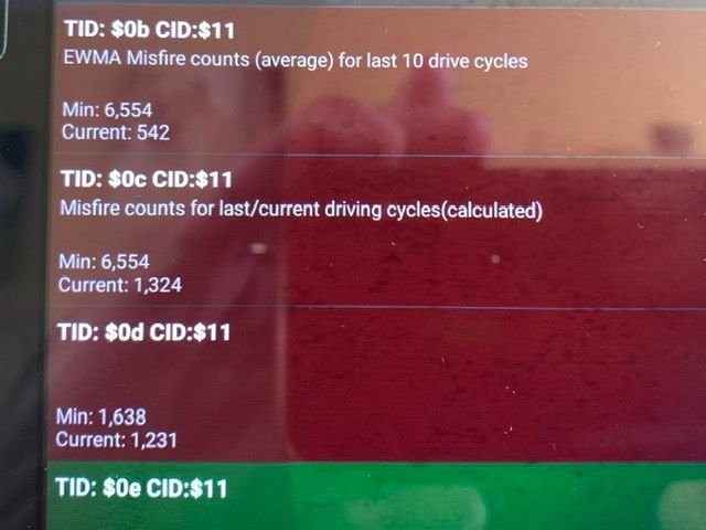

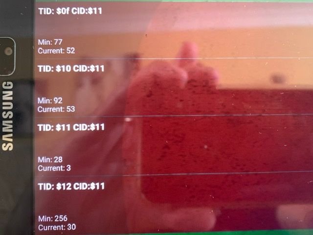

40 mile trip out for some lunch time grub in the sun. Noticed some very slight hesitation going up some inclines, like not all cylinders were firing correctly, or some sort of partial fuel blockage. Very slight, but even the better half noticed it without me saying anything.
got home and did an OBD11 diagnostic. The result were some red X’s - pics attached.
What do they mean?
thanks
Jules
