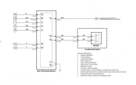

Lots of the system warnings, incuding the blinkers are driven by the BPM to a speaker in the steering column. It would not surprise me if the BPM volume is digitally programmable by the dealer.
Guess you could also just put a cheap audio amp on it such as:
Hi-Fi Stereo Amplifier Car Music Power Audio 2CH Amp | eBay

If you look at the right side of the steering column you will see some perforations in the plastic. A small speaker sits behind there. There are two deep holes under the column that have phillips screws. Remove them and the plastic steering column shroud top and bottom can be removed.
Then you can check and jiggle the wires to the speaker and see if you have an intermittent connection.

Does anybody have a wiring diagram for the X308 to chase down the speaker - could there be a fuse set separate for the blinker speaker? My indicator lamp speakers suddenly stopped working. I will pull the speaker per instructions here in.
