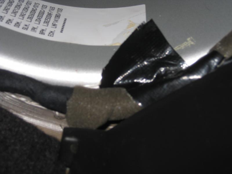

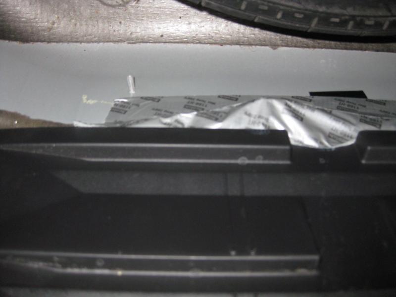

You should see a wiring harness in the back left rear part of car where spare tire is located. At the end will be two connectors, black with white inserts. After I completed the jumpers I just taped the ends to the back panel. I did find one connector to mate to one of them but not the other. You will find two bolt studs back there that were for the telephone module.
For 97-99 RT2 and RT5 are in center console
For 2000 in trunk
JTIS fig 17.1 does indeed say they are in center console. Not what I discovered by looking at the schematic for where the control modules are located. The cellular telephone module is located against the rear wall of the trunk when installed. That's what led me to find the connectors back there.
Attached Thumbnails bluetooth add-img_3244.jpg   bluetooth add-img_3243.jpg   bluetooth add-img_3230.jpg

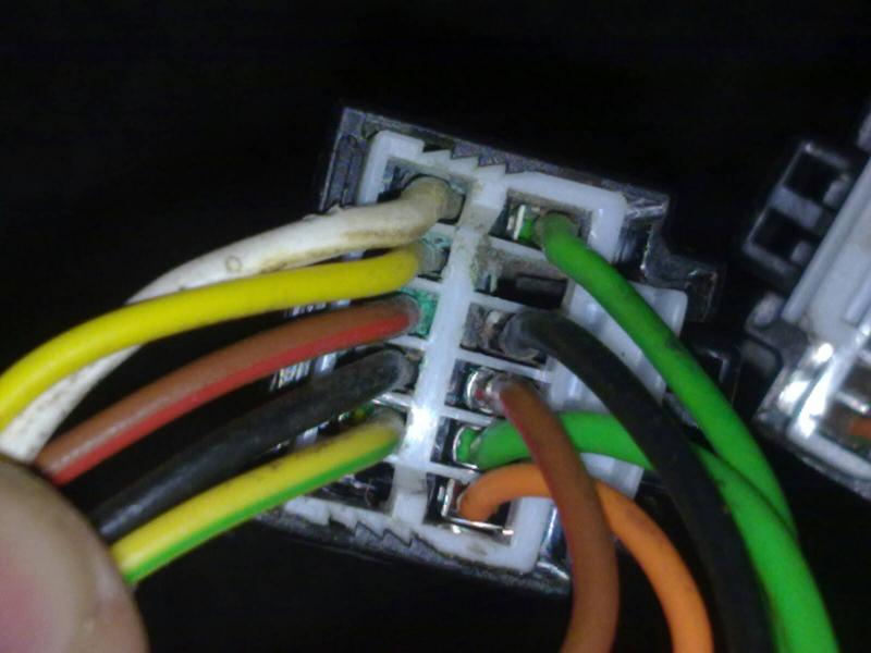

I have got confused on the numbering convention for the pins connectors and got them wrong. The attachment uses what I now think is the correct numbering (?), mapped against investigations with a voltmeter. I started with a similar I also tried using the numbers in the AMP engineering drawings you kindly provided - I assumed that if I looked at the drawings and connectors side by side, that would give me the correct numbering - perhaps these are engineering drawings where the perspective is not from in front of the paper but from behind.
Vis a vis the fuses - there are two phone related fuses in the UK passenger side fuse box (presume this will be the driver's side in US models), one for the centre console, the second for the PSE in the trunk. Both replaced.
Is it possible to open up connectors and add to them?
Looking at the photo, RT2-10 seems to have some verdigris staining - wonder if that is an issue?
Regards
DCAttachment 19017Attachment 19018

The engineering drawings are for the housings. The connectors in the trunk are the parts that fit into the housing.
So looking at the back of the RT2 connector in the trunk, the lines are 1-6 reading right to left on top and 7 thru 12 reading right to left on the bottom.
I see the corrosion in your connector. I think it is likely best to just mark all the wires correctly and cut them off from RT2 and RT5 and do the direct splicing of wires.
But you might try some baking soda/water and submerge the connector in it and then spray with electric cleaner afterwards.
Can you send a pic of the fuses and locations?
I found the fuses. I think the corrosion on RT2 may have shorted out those fuses.

Pull the fuses before cleaning!!
the battery lines RT2-3 &10 are from fuse FC20-9 5A
the ignition line power RT2-2 comes from fuse FC21-7 5A.
Both those fuses are to lines in your RT2 which looks corroded.

Many thanks - I did the clean safely - decided to disconnect the battery too. Just waiting for the connections to dry...
It is bizarre that the connections I need most are corroded. An occasional drop of water from the times I opened the trunk in the rain must have arrowed in on that one spot.
RT2-10 is likely to be defunct judging by the amount of brown rubbish that came out (rust?) when I did a mechanical clean with the eye of a needle.
Regards
DC

You might consider just cutting the wires and splicing together as needed. Either solder and shrink tube them or use a plastic splice connector and some RTV in it.
