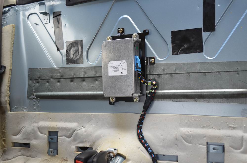

On the bulkhead behind the rear seat back.
I'd suspect a problem with the pairing procedure rather than the hardware unless a PO has modified it.

You are looking on the wrong side of the bulkhead - it is inside the passenger compartment, behind the seat back - you have to take the seat back off to find it.
