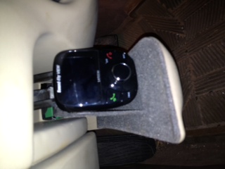

The Sound Fly is delivered with a male connector on the end of a tall stalk for power from a standard cigarette lighter socket. In the 2002 KXR the cigarette lighter is in the middle of the console, so that location would not work esthetically.

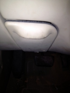

There is a small hinged storage compartment to the left and below the steering column. By removing the male connector from the Soundfly and drilling a small hole in the bottom of that storage compartment I could pass the stalk of the unit through the hole and slide it into the drawer. It fits perfectly and you can still close the compartment lid. The unit works with the door closed. See photos.

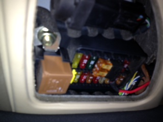

Power was picked up from the Fascia fuse box on the drivers side via a simple fuse tap. I selected fuse slot number 6 since it is powered when the ignition is off. See photo. From there it is a simple matter of connecting the Soundfry leads to the fuse tap and ground.

I don't really mind plugging it into the cigar lighter. If you do is the display upside down or does it rotate? BTW, nice simple solution if you are not an audiophile. I'm replacing the rear speakers this weekend with a pair of 6.5" Kickers to eliminate the typical old speaker buzz.
