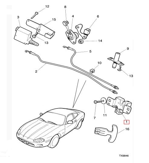

Gary,
I'm not sure from your description exactly what is happening.
Is the Latch (item 1) failing to engage properly or is the Actuator (item 3) randomly operating the Latch and opening the lid?

This happened to me a few days ago, it turned out to be the glow-in-the-dark Emergency Trunk Release Handle, item #16 on Graham's chart. The cable had been 'snagged' when I re-attached the side carpet around the CD stack, and tucked the edges of the carpet back behind the trim, I failed to notice the 'groove' or 'notch' in the trim panel allowing for the cable and handle to not become bound when closing the trunk.
The next time I tried to close the trunk it would not stay closed, and when I managed to get it to latch, it would no longer budge by switch, or key, until I pushed down on the trunk lid to get it open with the key. I found the bound cable and handle, and re-routed the handle properly and have had no further problems with the trunk popping open, or once getting it latched, not being able to open it back up.

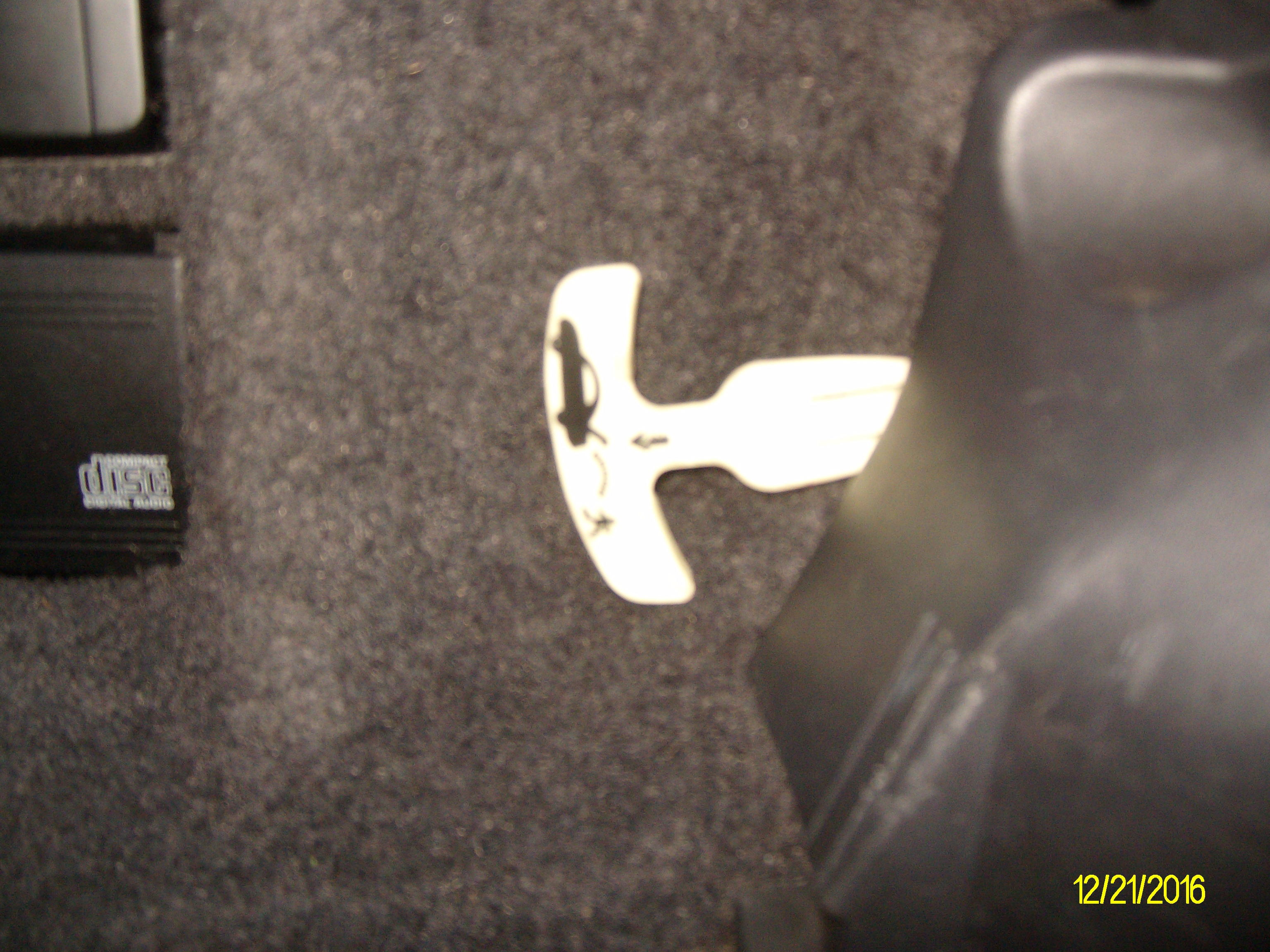

Originally Posted by worrasf
? photo please
Just as soon as the snow and ice melt enough. It is currently 40 degrees F, with a sharp breeze, which will hopefully melt the layers of ice and snow that have 'welded' my trunk lid, and most likely the doors and windows, shut for now. But it feels like a 'heatwave' today considering it was negative 4 degrees yesterday, with a one hour high of 17 degrees F, and not much better the last two weeks.

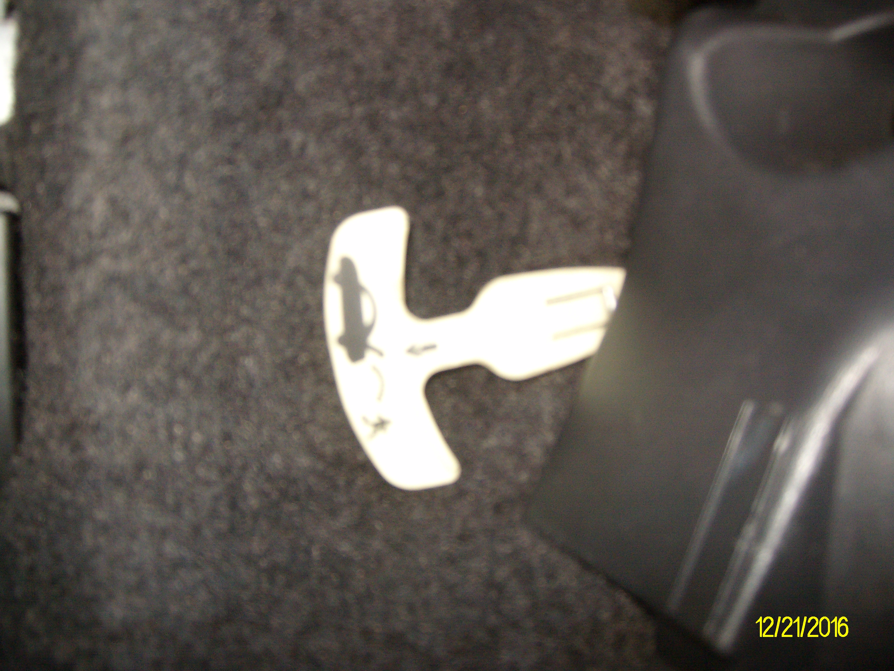

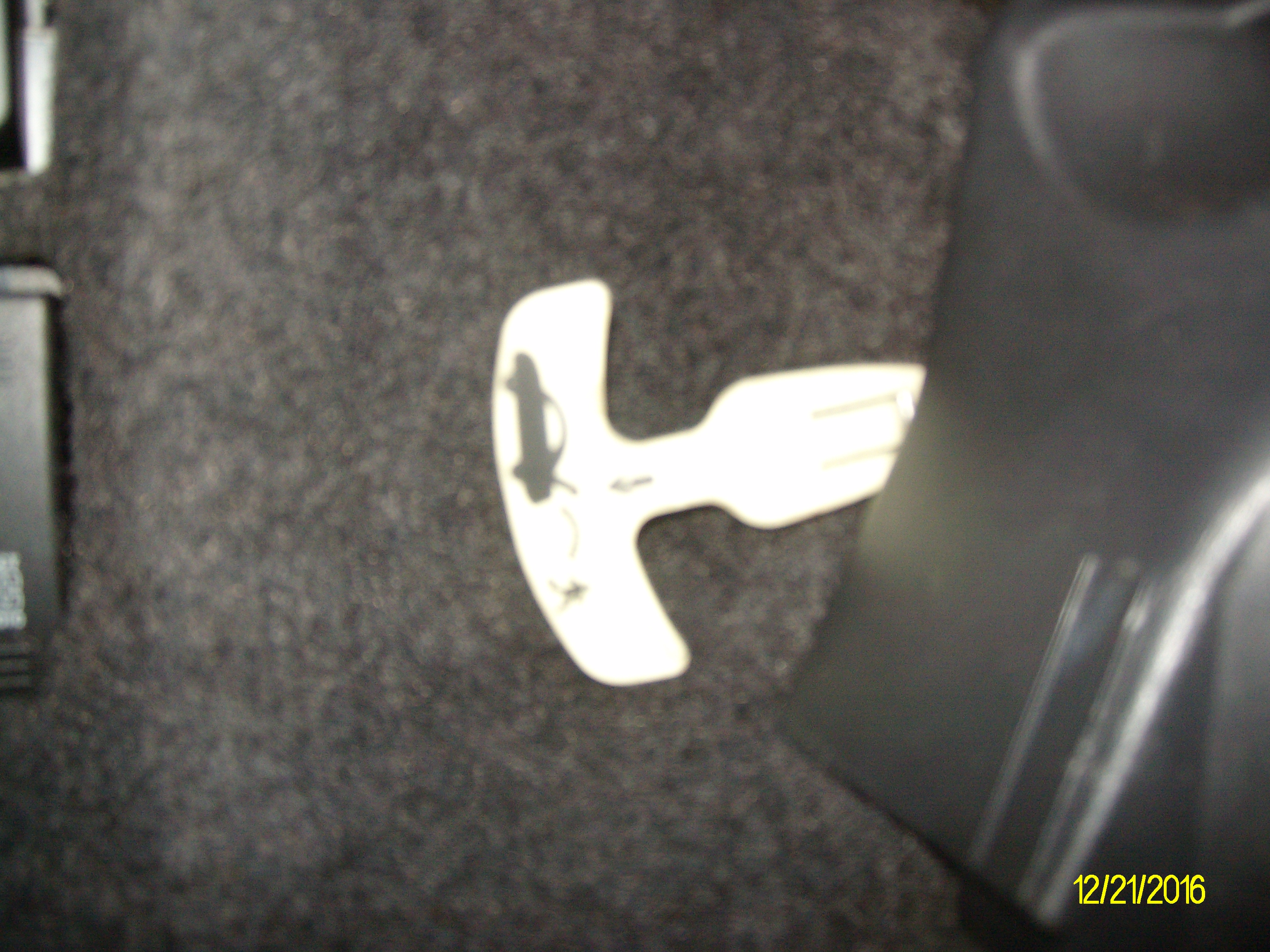

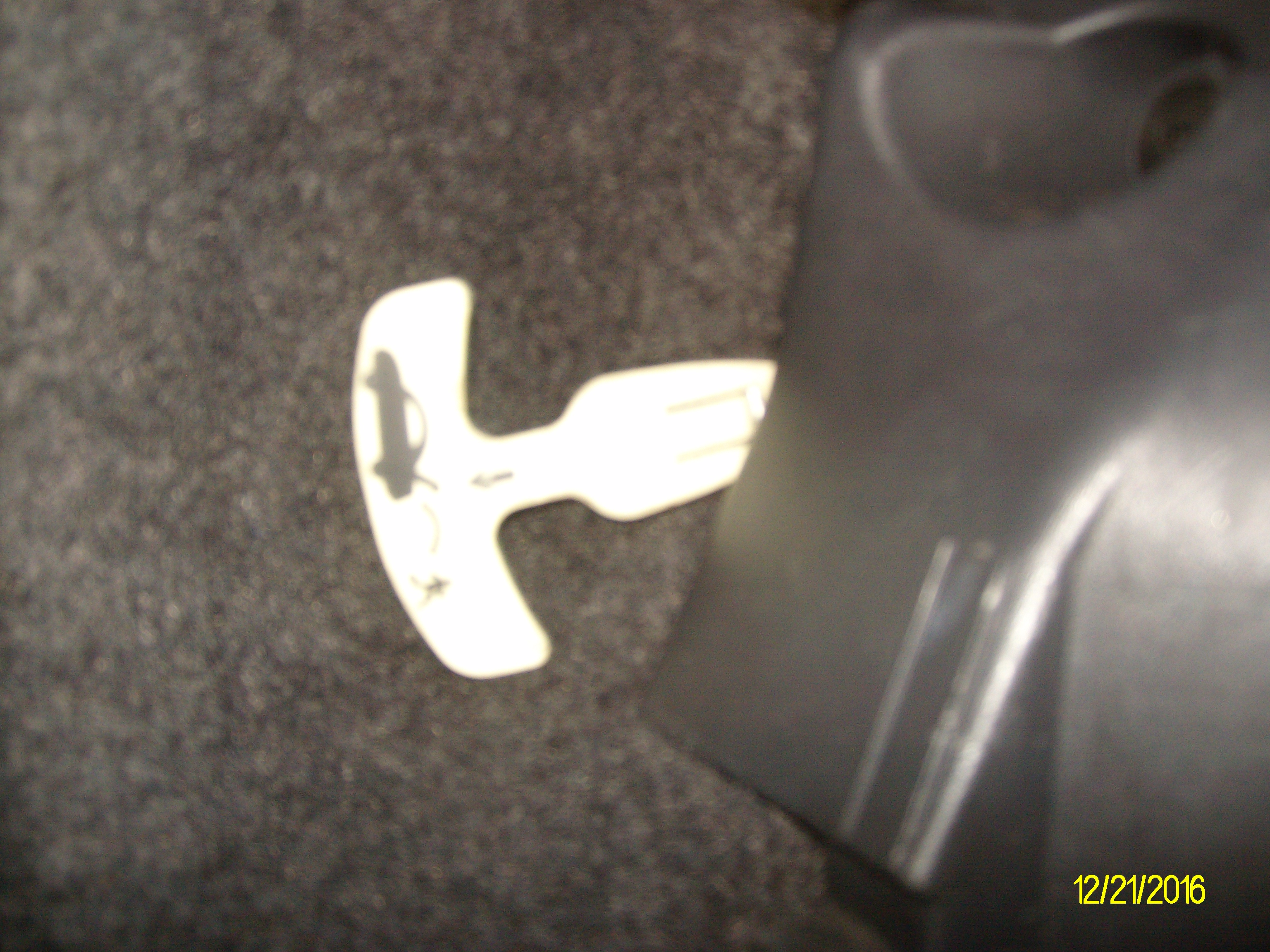

Here are some pictures of the Emergency Release Handle stowed in the recess, I apologize for the picture quality, my camera kept shutting off due to a low battery. No, I do not own a cell phone and in fact, I just upgraded from my original 2003 Gateway Desktop with XP that I had custom built for me, to a laptop with 8 Gigs of RAM and 8 Gigs of Primary Storage and somehow this thing makes videos and phone calls, and scares the crap out of me when it starts talking. I have got a bit of learning ahead, and have spent the last couple of weeks figuring out how this thing works.
Attached Thumbnails Boot problem-sany1138.jpg   Boot problem-sany1139.jpg   Boot problem-sany1140.jpg   Boot problem-sany1141.jpg   Boot problem-sany1142.jpg
