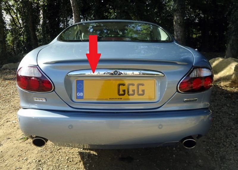

This one?
On the Coupe, once the lid liner is released the chrome trim fixing nuts are visible. I don't expect the Convertible would be any diferent.

Yes that chrome trim piece. I did pull the boot liner off, found what I thought were the two nuts holding it on...removed them....trim did not budge.
