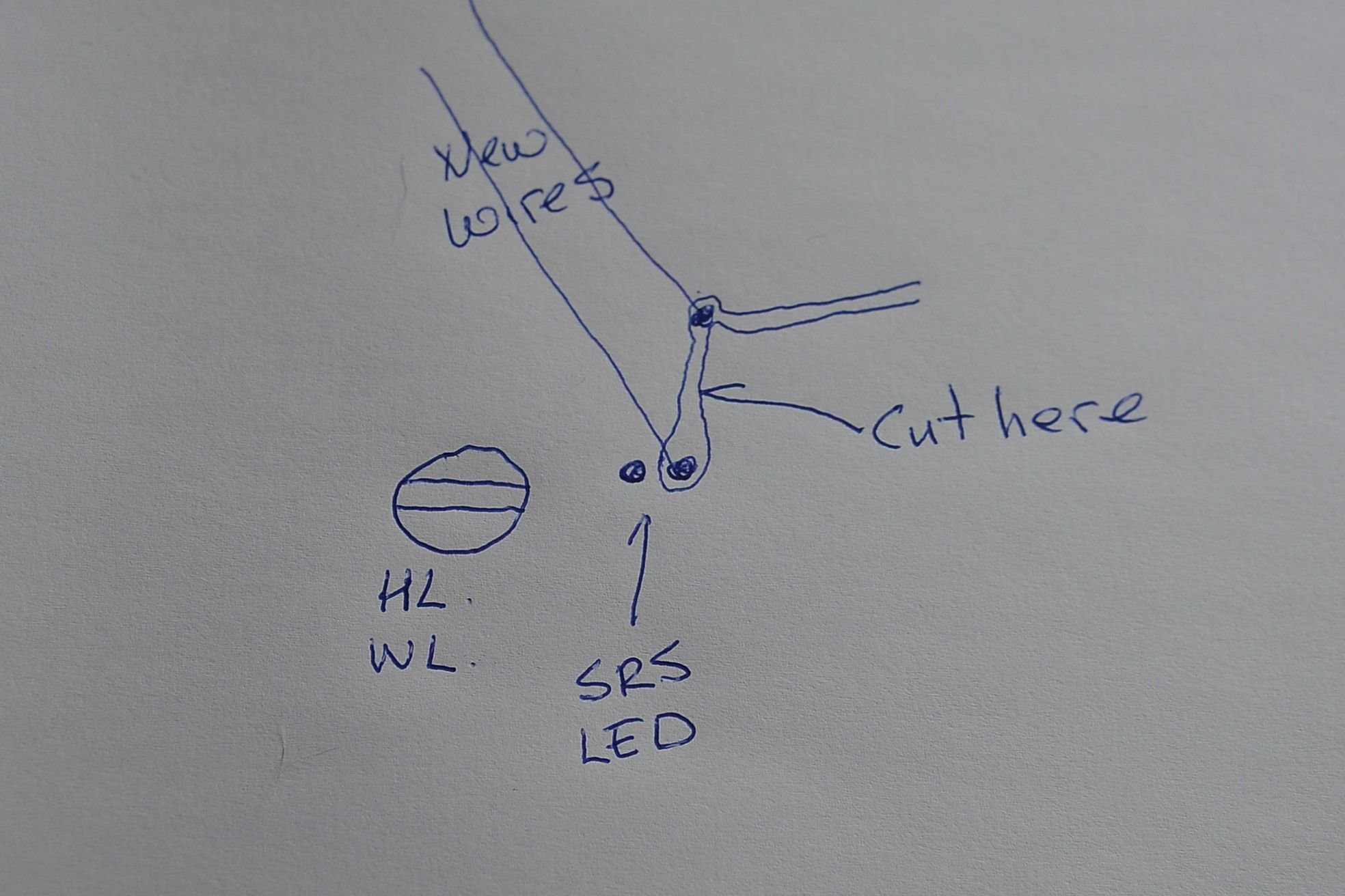

Once you have the clocks out remove the rear white cover 6 Torx. Establish which is the main beam warning light. ( remove bulb and look through for the blue beam logo) To the right of the lamp holder you will see two larger soldered blobs , these are the SRS led joints. I did not take a picture but have drawn it below. Remember the SRS light is on the LHS as you are looking at the back of the instruments. You will see a track leaving the right hand blob of the SRS led and going away for about 1/2 in to another smaller solder blob. If you cut this track you will turn the light off ( option 2). If you intend to fit a timer cut the track with a scalpel and solder your thin wires to the large led blob and to the smaller one so that joining the wires will bridge the cut you just made. Do not let the solder touch anything else the tolerances are small. Use a lens or lupe to check your work . Refit the white cover and refit to the vehicle . With your two wires disconnected the SRS should not light at all . When connected the SRS should come ON.
With the timer disconnected check which of the three output terminals are connected. Your two new wire go to them .
Connect the timer to ignition live ..drivers side fuse box fuse 4 is a good choice and earth the other. Turn on ignition,SRS will come on and after 4 seconds the blue light on the timer will come ON and the SRS go OFF. I put the timer up the the left on top of the heater outlet. Thank you Mr MOT man.
If anyone takes a photo of the back of the board please post it and I will replace the drawing below.
