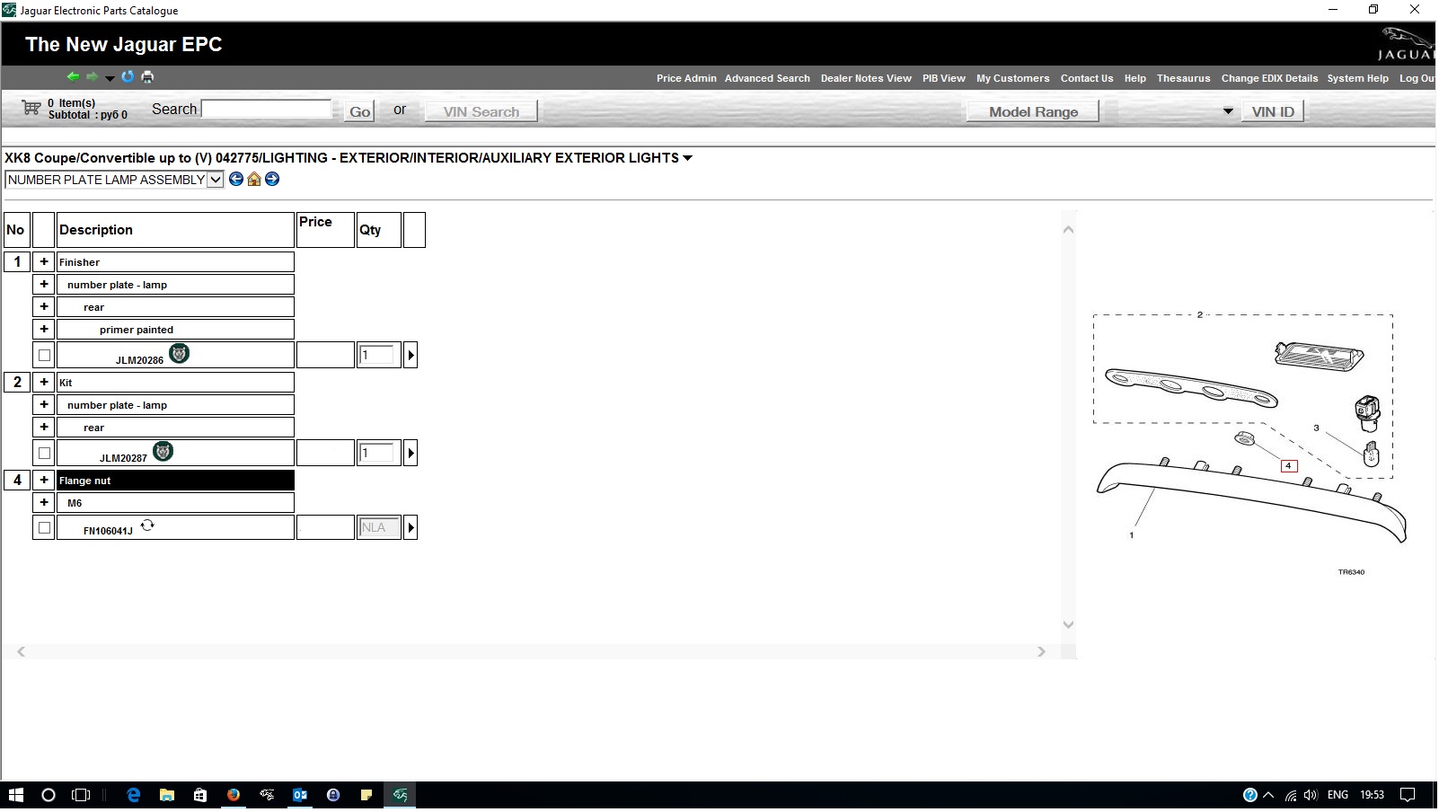

The whole Number Plate Lamp assembly? (see item 1):
One or more of the M6 nuts loose or missing. You'll need to undo the liner to access them.
