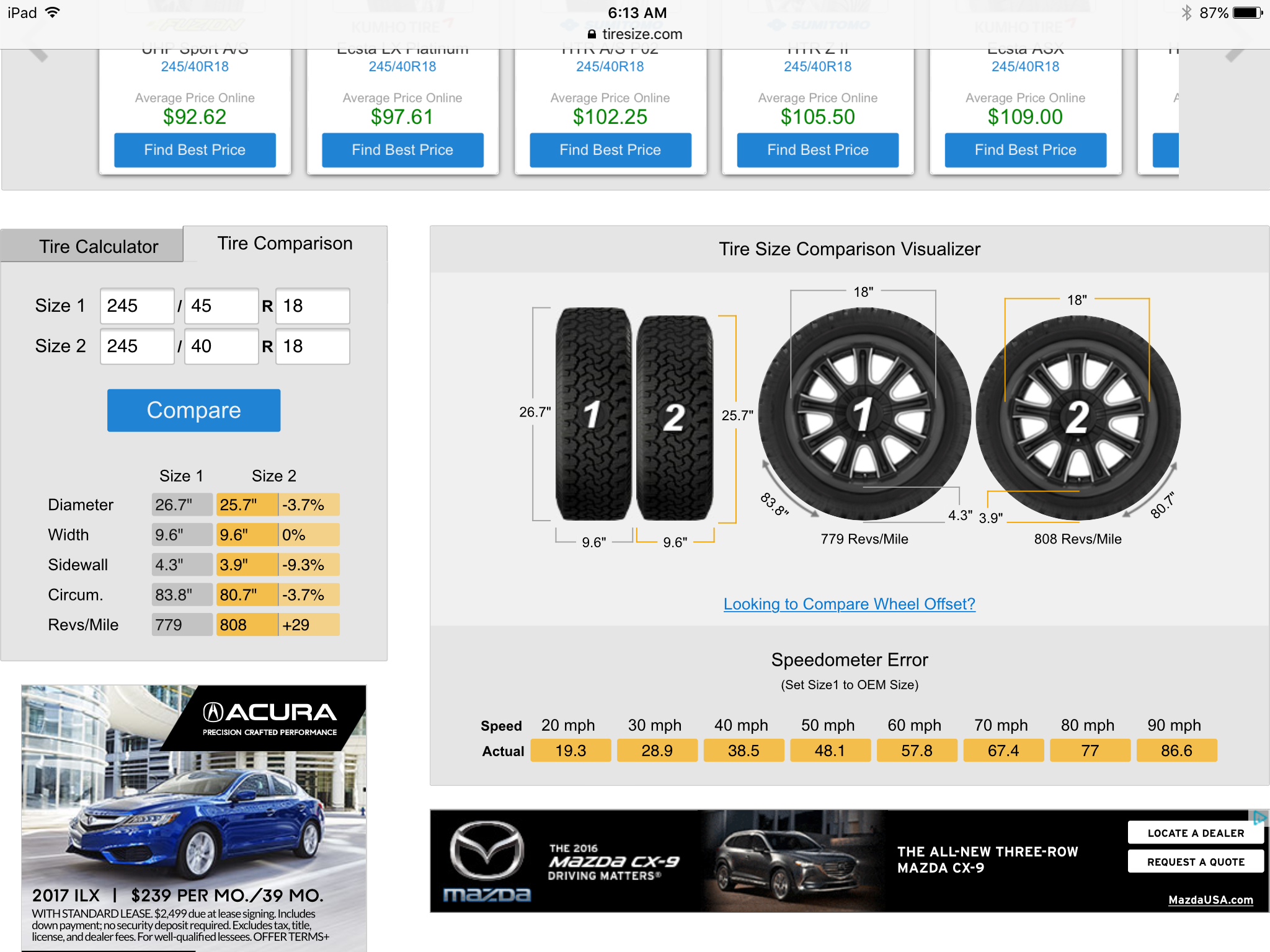

Have to replace all 4 tires on my 2001 XK8. The recommended size is (front) 245 45zr 18 and (rear) 255 45zr 18. I have 2 new 245 40zr 18's in my garage. Can i use those in the front instead?. Any down side to doing so?

You need to keep the overall diameter on the tire within 5% or so of stock to prevent the ABS from throwing a fault.
https://tiresize.com/calculator/

Yes you can, no problem. Did the exact thing on my last xk8

would i then keep the rear offset tire at factory 255 45 18 or replace with 255 40 18

From: Sacramento
thank you, very helpful tool
either, doesn't matter really. They'll both work
