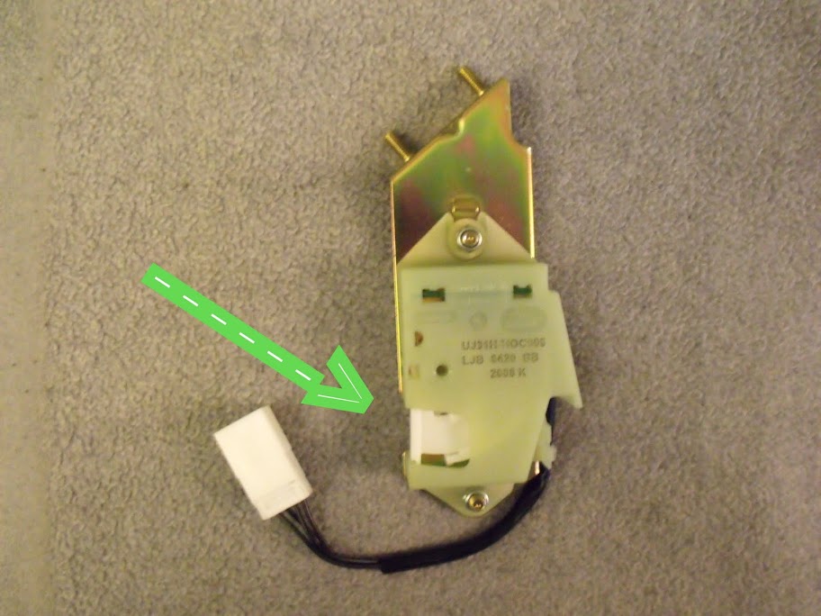

C. Here's the trick. Drill a small hole (about 1/16") in the end of each of the two studs on the new switch bracket about 1/4" deep. (there is a small dimple, dead center on each stud that perfectly lines up the drill bit.)
D. Now then, take a "low E" guitar string (if you don't have guitar strings around I would suggest buying one at a local music store it's the perfect rigidity for this use) cut it in half.
E. Make large masking tape flags on one end of each of the two lengths of guitar strings. (The flags come into play later)
F. Now feed the end of one of the guitar strings into the upper of the two holes. And through towards the floor board. Be sure it goes through the large opening where the brake pedal goes through.The masking tape flag keeps the string from just falling all the way through the hole.
G. Now mix a small amount of "JB Kwik" 5min. Steel epoxy. Coat the very end of the guitar string with the epoxy and insert it into the hole you drilled in the upper stud on the bracket. Important! Be sure to be careful NOT to get epoxy on the threads of the stud.
H. Now, repeat G. With the other length of guitar string through the lower hole and glue it into the lower stud on the bracket. Do not get the upper and lower strings mixed up or the bracket will go in upside down.

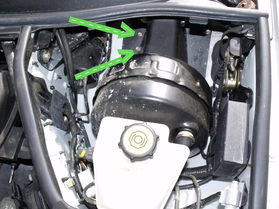

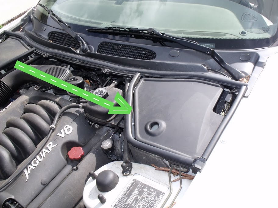

The nuts which mount the brake switch bracket to the vehicle's body are located under the hood/bonnet. After opening the hood, you need to remove the plastic cover identified by the green arrow below. Simply insert a finger or two into the hole presumably provided for this purpose and lift up and in towards the center of the car.
Next, remove the two 8mm nuts indicated in the picture below. You will need an extension if using a socket wrench. I used a 12" extension and had a few inches to spare.

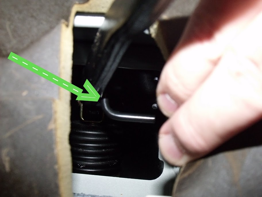

Now move to the vehicle's interior and unplug the switch's electrical connector, which is located behind the brake pedal. Mine was readily visible, but even if yours isn't, you should easily be able to find it by tracing the wire from the switch.
Remove the old switch and replace it with the new one. NOTE: The switch is designed to be engaged when the brake pedal is RELEASED. You will probably be working blind (I was unable to see the mouting holes no matter how I positioned myself), so if you do not orient the new switch properly, you will waste a lot of time trying in vain to mate the bracket's studs to the holes where they belong. There is a horizontal bar that protrudes from the brake pedal stem. This bar and the actual switch that is activated are shown in the two photos below.The side of the switch housing that allows the switch to make contact with the bar should face toward the front of the car.

Ok, just did this repair in about fifteen minutes. Can't believe how some posts make this sound so much more difficult. As long as you take out the seat and use a broom or similar wood dowel to hold the brake pedal in place, the rest isn't hard.
Even operating blindly it's possible to get the studs into the holes. If you don't have a helper to put the nuts on the studs while you hold the switch in place, tape the switch to the brake pedal lever so the switch doesn't move during the time it takes to get out of the car to the hood area to finish the job. I had a helper so I skipped the tape trick but even so it's very doable as a one man task.
