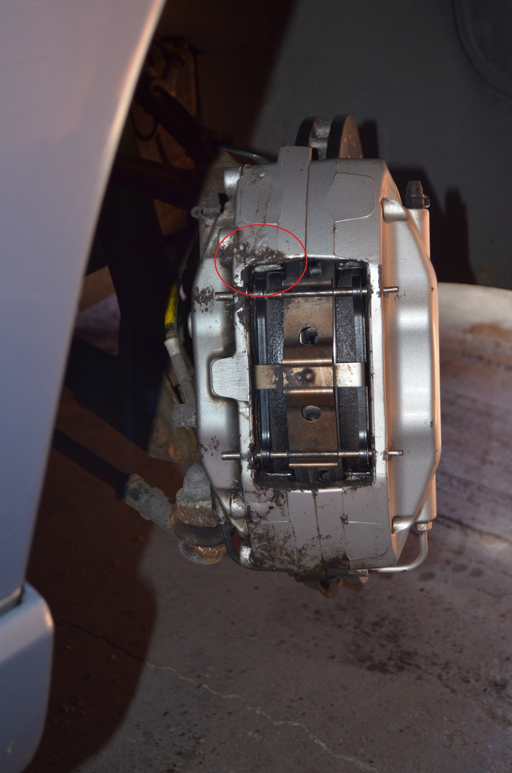

Two issues I had with the Brembo brakes on my 2005:
1. the caliper body oxidising. This is the front RH (see top left corner circled in red) which was the worst of the four.
The caliper body oxidation was distorting the chromed slipper plate and causing the pad to bind.
2. the pad retaining pins are very small diameter compared to those on standard brakes. They can bend and again this causes the pads to bind.
