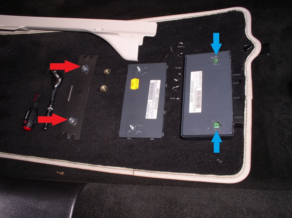

Ripping the two fixing studs out of the Seat Module lid is a regular issue:
The weight of the driver or passenger inevitably presses down on the bracket and as this is a rigid fixing, something has to give. With the Seat module, it's the lid that breaks.
After breaking two in fairly quick succession, I fitted the replacement with rubber domestic tap washers on the studs between the Module lid and the bracket to give it some flexibility.
Coming up to a year now without any further breaks.

No need to remove the seat, the two nuts which secure the bracket are accessible on the underside of the seat. It's a five minute job, you just need to be able to stand on your head in the footwell!

I'd agree with renaultvation about not needing to remove the seat on the 4.0 litre but the last of the 4.2 litre cars have deeper seats and I couldn't get to the harness plugs on mine with the seat in place.
Here's the JTIS procedure for Front Seat removal:
JTIS - XK8 Front Seat.pdf
Because I have the Coupe, I didn't bother to lift the seat out - just tilted it back as shown on the RH of this photo:
