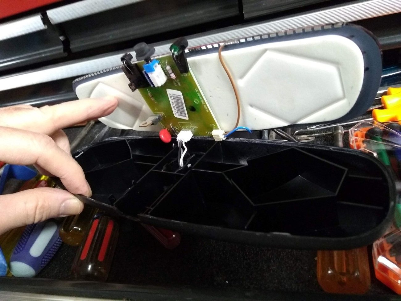

The headlight sensor is an LDR (Light Dependent Resistor) along with a pot to adjust the sensitivity. You can see it here in this photo from the DVR mirror thread:-
The easiest solution would be to get hold of a scrap mirror from someone and use the PCB from that.

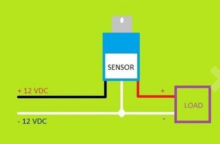

I wonder if this would work, I do not understand all the circuit and resistance practices but the diagrams of how people use them should be easy enough to implement when I get the pinout for my system.
Link to product on Amazon Link to product on Amazon

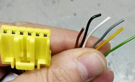

This is my harness:

Just looked it up. Yellow blue wire does control auto headlight.
Apply
Image 1 of 2. See YU (yellow blue) wire to auto on selector.
2 of 2
12v from a switched ignition source, headlight should turn on only when ignition is on. If auto is selected.
John

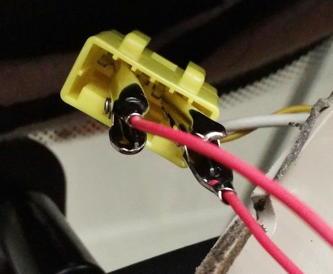

So I bypassed where the sensor would presumably control the on and off. I got the results I wanted with the lights at first, they went on when the car was on and off when I turned it off. There were two issues that made this unworkable.
1. Even though the lights were off when the car was off, when I opened the driver door I got the beeping sound like the lights were on.
2. The dash lights stayed on when the car was off when I did this bypass.
