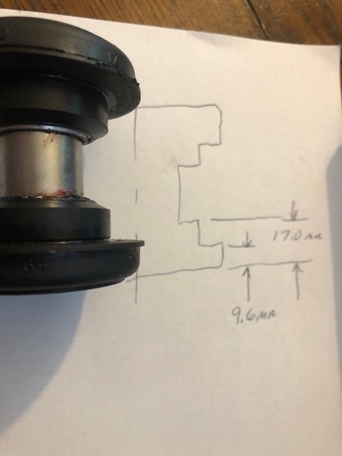

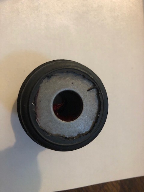

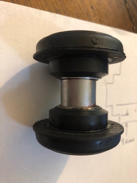

Hi,
I've attached a few photos. One has a sketch with the measurements. These are Jaguar parts & a photo of the bag with the part number is attached.
Attached Thumbnails Which Bush set is right (front upper wishbone)-bushings-1.jpg   Which Bush set is right (front upper wishbone)-bushings-2.jpg   Which Bush set is right (front upper wishbone)-bushings-3.jpg   Which Bush set is right (front upper wishbone)-bushings-4.jpg
