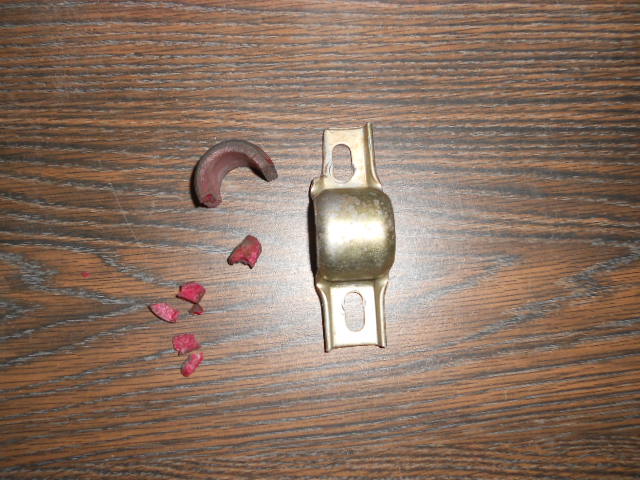

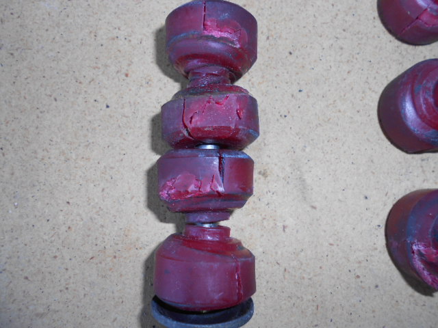

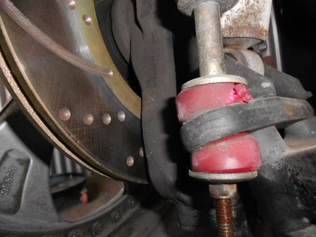

i wouldnt use Poly bushes anywhere!
pic of my front anti-roll bar/anti-sway bushes.
they just hardened up to being brittle and broke up into pieces.
wow, this is not good. if these break up that easily, wouldnt the same happen to the rack bushings? I am debating on poly or standard rack bushings. I have both sets new lying around. I think I just made up my mind despite the fact they are harder to install and not as firm in steering, I will be installing the rubber ones.
No, the stress on the rack bushes is different to the swaybar bushes. Also not all poly bushes are made equal. I used the blue ones from Superpro, these are the bushes the guys in the UK use in XJS racing.
I have poly in my sway bar and they have been there for 6 years without issue, I also have poly in the front subrfame, the big round ones and the rack all of these I have had no problem with.
I have had problems with the Poly front upper wishbone bushes, not the bushes them selves but the tube. I have excessive wear on the tube. They also cause too much NVH so these will be replaced with rubber as soon as I get the chance.
