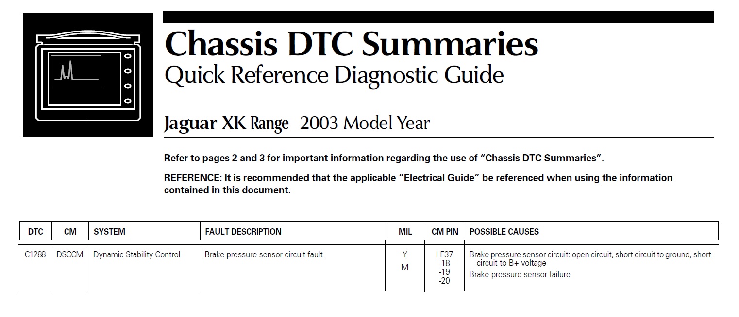

Hi, '03 XK8 4.2 has "DSC system fault" Amber warning which turned up C1288 "Pressure transducer input circuit failure".
This leads me to suspect part no.XR828106 needs replaced, anybody done this for this fault code? and, Was it successful?

JTIS (Jaguar Technical Information System) gives this for C1288 (see Possible Causes in the right hand column:
Could be either a harness or a sensor fault.
