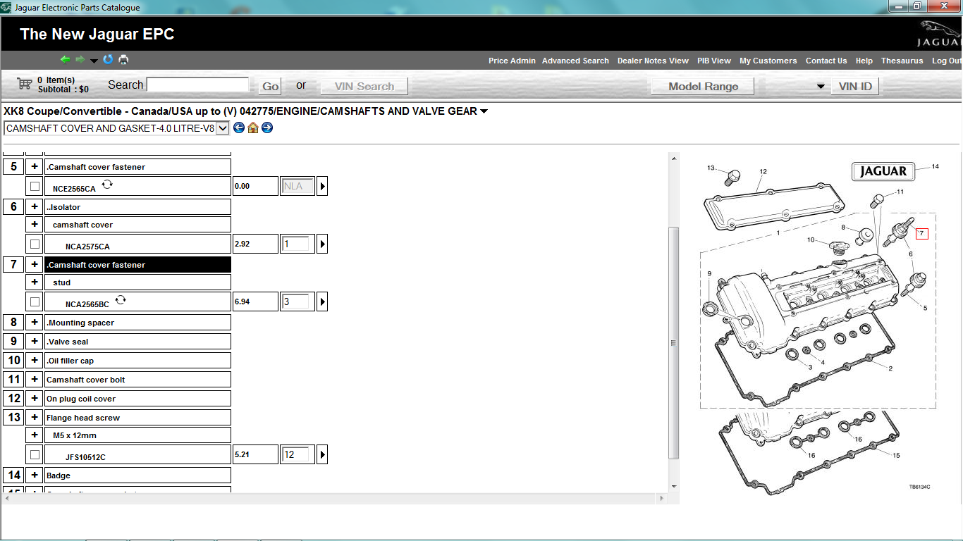

In the midst of replacing my secondary tensioners I've discovered several of the hold down bolts are missing. I cannot find the Jaguar part number or specifications for the bolts in the FSM Parts Section. Does anyone have the Jag part number?
Are they all the same length?
I would like to replace the two lower rear bolts on each side with Allen head bolts to facilitate installation and possible future removal, so I also need the complete specifications so I can check sources like McMaster Carr for Allen head replacements for those two.

Does this help?
Attached Thumbnails Cam Cover Bolt: Specifications and Substitutes-untitled.png

Norri,
Thanks, that helps.
I have tried to install the EPC on my laptop, but have been unsuccessful. I'm not a computer-savvy guy and after three attempts, that took several hours, have given up. I even tried to download the pdf version of the Parts Catalog but no joy.
