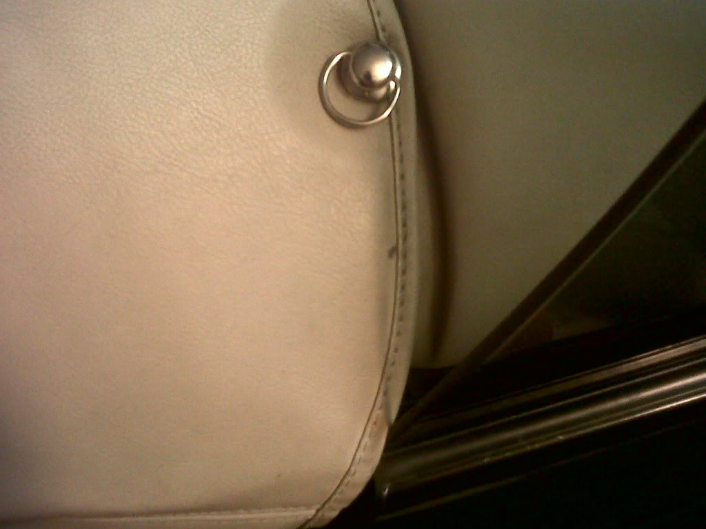

My cover is tucked all around. Here are the pics without window up and then with window up.

and if you notice it pushed the cover back about 1/4" fromthe little ledge that the leading edge tucks into on the leather piece

That doesn't look too bad. A shoe repair guy could probably adjust the profile slightly on the cover if you want to fix it...or DIY if you are handy with a sewing awl.

I didn't even notice that on mine. My tonneau is touching the window, and I guess the window pushes it back by maybe 1/4 inch, but it doesn't bother me. Like I said, I didn't even notice it until you pointed it out.

I am not worried about it. It just pushes back a bit and moves it slightly. I think over time it would wear on the cover but don't see me doing it that much
