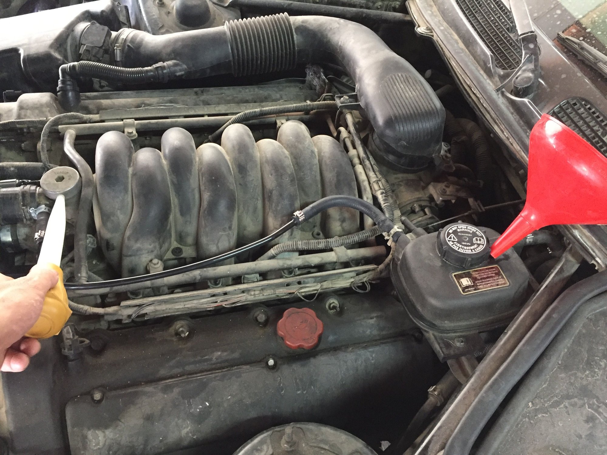

Hi folks, just an update and stupid question. The part came in and swapping it out took about a half hour but my new problem is where do I refill the rad? Do I fill it from the top of the thermostat tower?

Fill the brown container left rear of engine to the top. It has black threaded cap and is inches away from throttle body.
you'll see the fragile plastic pipes coming out of it traveling on top along the black plastic Jaguar v8 cosmetic valve cover.

Default Filling at both tank and top of tower
Did a full R&R of cooling system recently. Taking cap off top of the cooling tower makes it easier to squeeze radiator hoses and burp air out of system.
Put lots of rags around it to stop any coolant leaking down to the knock sensors underneath/behind. Otherwise you’ll get a Restricted performance message.
