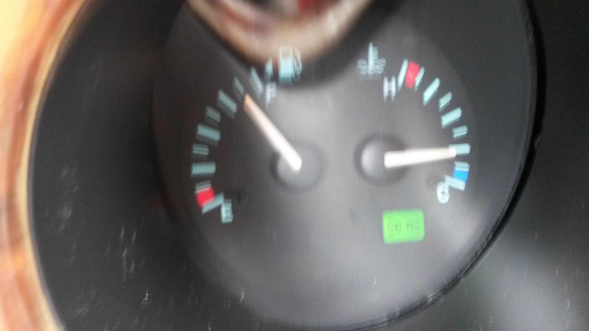

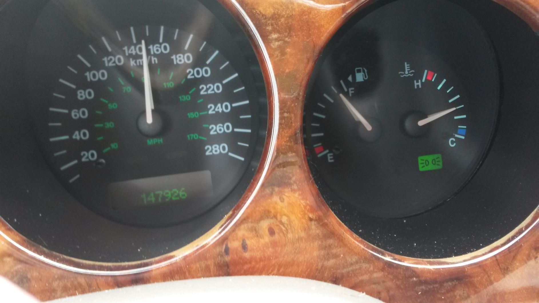

I've been having an intermittent problem with the temperature gauge in the car going cold when I take it on long drives. I had the mechanic replace the thermostat, flush the rad and replace the coolant and for a couple trips it was fine but now it's happening again.
Any suggestions are welcome as my mechanic is stumped. At 120 - 140km the gauge is normal but get it up to around 180 - 200km and the temperature drops like a rock and I start to get worried about damaging the engine.
Sorry about the last picture, 200km and 1 hand on the wheel.

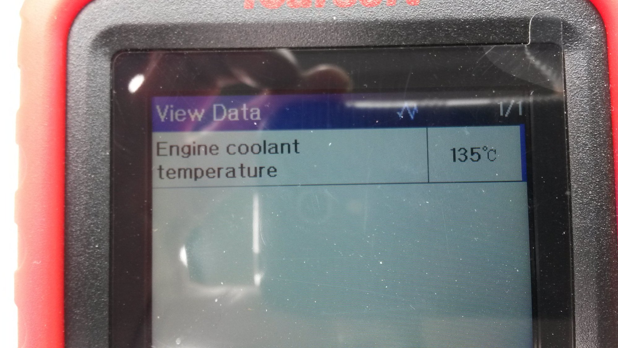

I plugged in the OBDII reader and it tells me "no fault codes". I checked the ECM and got some numbers that mean nothing to me but might be related. With the engine warm and gauge in the middle and idling I get coolant temperature at 132 C, down stream oxygen sensor bank 1 is .51v, down stream oxygen sensor bank 2 is .43v, heated oxygen sensor bank 2 is .11v, mass air flow sensor CPU is 1.32v. I got a few other numbers, fuel trims etc. Also checked the coolant level and it looks good. Hopefully this can help someone point me in the right direction.

You're seeing 132 degrees Celsius? Isnt that then 274.6 farenheit? Barring a typo that sounds way too high to be safe.
frankly I'd think youd be overheating and blowing hoses if this is true. If memory serves me Steve's RealGuage tops out at 245F. That's the top of the temp scale on the guage.
I hope this means you have a defective coolant temp sensor, cheap part ez to replace. But why your factory guage would not be pegged in the red, with your ac disabled (car does it automatically if above a temp way less than 275F) I cant figure.
Would you mind confirming that you get a 132 degree celcius reading?

I took the car for a little run and the coolant temperature is 135C. See picture. Could it be that something is wired backwards as the engine does feel hot? I get no fault codes with the OBDII scanner and when I went through the list of diagnostics none of the sensors tested bad.
The hoses look good and the car drives great even when the temperature gauge drops, no strange noises or odd smells and the gauge goes back to normal as soon as I slow down when going through a small town or stop to stretch my legs. Then it won't start to drop again until
I get it up to 140km or so. When I pull over and lift the hood the engine doesn't feel excessively hot, no big blast of super heated air and no bad smells, hissing noises or bulging hoses. By the time I drop the hood and get back into the car the gauge is back to normal. I'm starting to get a little nervous now as I'm 500+ km from home with the car.

I can't account for your in dash guage action, but sometimes the simplest answer works. I'd change the coolant temperature sensor.
I had an incident recently where the car started getting up to 240 degrees farenheit. There were noticable drivability issues.
No one else has commented, but I can't imagine that you'd be driving far at 270+ degrees. Especially with these engines so susceptible to overheating damage.
A quick trip to auto parts store, 10 minutes with a wrench and sensor changed.
I admit this goes into a loop when the dash displays a low temp, OBDII shows crazy high temp, but no overheating automatic actions take place.
My recommendation: change the sensor, see what settles out.

Thanks for your help. The car has been sitting turned off for 6 hours now and the coolant temperature reads 98C, outside air temperature 12C. This is only 37C different than when it was running with the temperature gauge in the middle. I'm thinking you're right and the sensor is shot
or the Icarsoft OBDII reader is. What temperature are these cars suppose to run at?

The standard temperature gauge gets a lot of flack for being a placebo, but when working correctly it does show if the engine is over or under the correct operating temperature. At 135C the gauge should be pegged at the top, so the problem is more than just a faulty sensor sending the wrong values, the gauge is displaying the wrong values also. This is a table showing what the gauge should be reading versus the engine temp. This is for my 2001 XKR, you would need to confirm the 97 works the same way:-
°C = °F
0-80 = 0-176 - Warm up
80 = 176 - Thermostat starts to open (80°C to 84°C)
83 = 181 - Start of Normal range on Factory Temperature Gauge
90 = 194 - Radiator cooling fans come on at Slow speed
92 = 198 - Normal
94 = 201 - Normal
96 = 205 - Thermostat fully open
98 = 208 - Radiator cooling fans come on at Fast speed
100 = 212 - Normal
102 = 216 - Normal
104 = 219 - Normal
106 = 223 - Normal
108 = 226 - Normal
110 = 230 - End of Normal range on Factory Temperature Gauge
110+ = 230+ - Overheat
127 = 260 - Maximum on factory temp gauge
