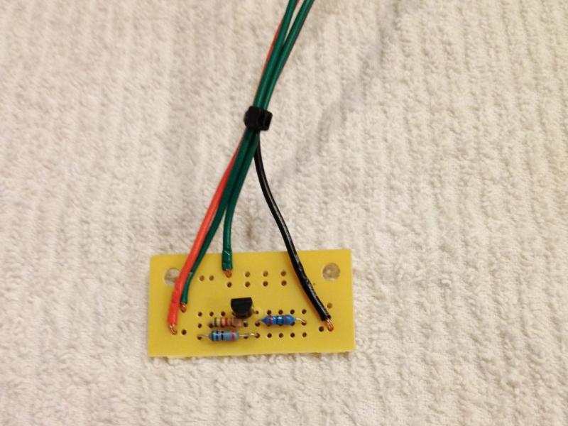

So, I finally built up the circuit in a permanent way and tied it into the sport switch. Just need to run 1 signal wire from the switch to the circuit, all the rest fits nicely next to the CATS control in the boot. A little double stick tape to insulate the back side of the board also serves to attach it to the control box.
The Sport switch put +8V when "off" and ties to ground when "on". The circuit is a voltage divider between the +5 and GND pins for the accelerometer sensors and the transistor acts as a switch such that it's open when the +V is applied from the sport switch and closes when tied to ground.
All built up the sensor line has +1.6V when sitting still and +2.2V when Sport is turned on.
If I ever get a copy of AutoEnginuity I could know for sure that it's toggling the mode but by the seat of the pants feel of it, I would say that it works.
Even if the voltage needed to be a little higher, it would just be a matter of changing the resistor values a little. The principle seems to be sound.
Has been a fun little experiment so I'll toss it out there in case anyone else is interested.

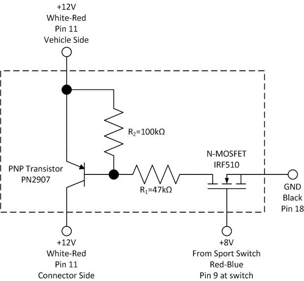

Default Figured it out (I think)
I finally got back to this little project and am pretty sure it is working properly this time.
It turns out CATS is a stand alone system and unlike many of the other modules, it only communicates with the rest of the car when it is 1) turned on and 2) when there is a problem, so if the controller is turned off them there is no communication and no error messages.
I'm using the term communication liberally here, as the only real connection between CATS and the outside world is a single line that runs to the instrument cluster. When the controller pulls that to ground the cluster shows the SUSPENSION FAULT message but so long as the controller is off or unplugged there will never be a fault message, no matter what else happens. This simplicity is why unplugging the controller lets someone use non CATS shocks without a problem.
It also happens that the "system off " mode is the FIRM setting, which is something that we can take advantage of. I tied it to the sport switch such that:
Sport off -> CATS on -> suspension soft
Sport on -> CATS off -> suspension firm
Here is what I wired up and how it's connected:
I am not generally a fan of cutting wires but if you want to try this save yourself a lot headache and just cut the wire going to pin11 and tie in the circuit. I tried to extract the pin so I could remake the harness without cutting anything but I spent HOURS fiddling with it, eventually broke the wire, resorted to pliers and then when the pin did finally come out of the connector it was in 3 pieces. I was able to get a replacement pin and put it back together but by that point I was fed up and just spliced the thing.
The currents in this circuit are tiny, so the transistor and resistor choices are not especially important. The largest current is on the +12 ignition wire to turn the controller on and off, which carries about 6mA, so not very much at all. The components I used are what the local Radio Shack had in stock (which isn't much these days).
When toggling the sport switch there is an audible click in the controller when it switches on and off. The suspension can be toggled any time while driving without problems and there is a subtle but noticeable change in the ride.
For now, it's still in breadboard form in the boot, but I'll solder it up to make it smaller and more permanent.

If I am reading the electrical diagram correctly? Could you not simplify your circuit by omitting the FET and connecting R1 straight to pin 2 of the sport switch?
Switch diagram to save anyone looking it up:
Last edited by Stumpy; Nov 17, 2012 at 01:43 PM. Reason: add Sports switch diagram
Old Nov 17, 2012 | 08:37 PM
  #35
ccfulton's Avatar
Posts: 2,953
Likes: 1,120
From: Phoenix, AZ USA
I think you are probably right about that but there aren't any wires connected to that pin such that it is easy to tap into. It's a good idea, and would be a more elegant solution so I might pop the switch out again and see if it could be used.
I'm not really sure what that transistor in the switch is for, unless the original design intent was something similar to what I am trying to do with this add on circuit.
