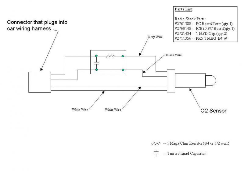

I know that this comment will offend some of us - but I gotta ask it anyway...
Has anybody out there "gutted" their cats? I mean, taken a big honkin' hammer and screwdriver and crush the material inside the cats - hollowing them out? How did that sound?
Yeah, it'll pollute more - but I live in the midwest USA - where "the wind goes sweeping down the plains" and besides, I'm wayyyy more of a heathen in many other ways!
I'm thinking of doing just that - looking for a better sound out of my "R"
Plus, of course, adding some home-made MIL eliminators to the secondary O2 sensors. (I know the circuit pictured is not for a Jaguar, but I just included it to illustrate how easy a circuit may be to build)
http://tinyurl.com/afczs4s

Originally Posted by plums
... towards someone else ... no thanks ... its the same as someone dumping chemicals into the headwaters of the Mississipi because "it'll flow downstream anyways"
Well, Plums I can see your point - mostly because, living on the Missouri river in Kansas City - For my entire life, every day, I've been drinking the water that persons Omaha and Sioux City had just crapped in!
But I guess I just cant imagine that automobile exhaust pollution blowing out of the Kansas City area is pooling around somebody else's home in Chicago, St.Louis or Memphis. The Midwest is a BIG place! - And I don't drive my car very often either. Should I put fuel injection and cat convertors on my 1962 Dodge?
Hey, plums, I'm not saying your wrong, I suppose, to me, its a matter of numbers and geography - If I lived in LA or Denver, I'd never consider gutting my cats. And Hey! At least there's not lead particles from TEL drifting in and out of all our lungs anymore.
bfsgross, You are right, the cars I have gutted the cats on (sorry Plums) HAVE ended up sounding a bit raspy.... My son's Mazda RX-7 sounds kinda cool but a rasp is definitely a component of that sound - I had thought it was the innate sound of the rotary motor. I used to have a '79 Z-28 that had gutted convertors and when it was revved, it too had a bit of a "rasp" to it. Perhaps this is NOT the deal for my XKR.
Hmmm Reconsidering now....
