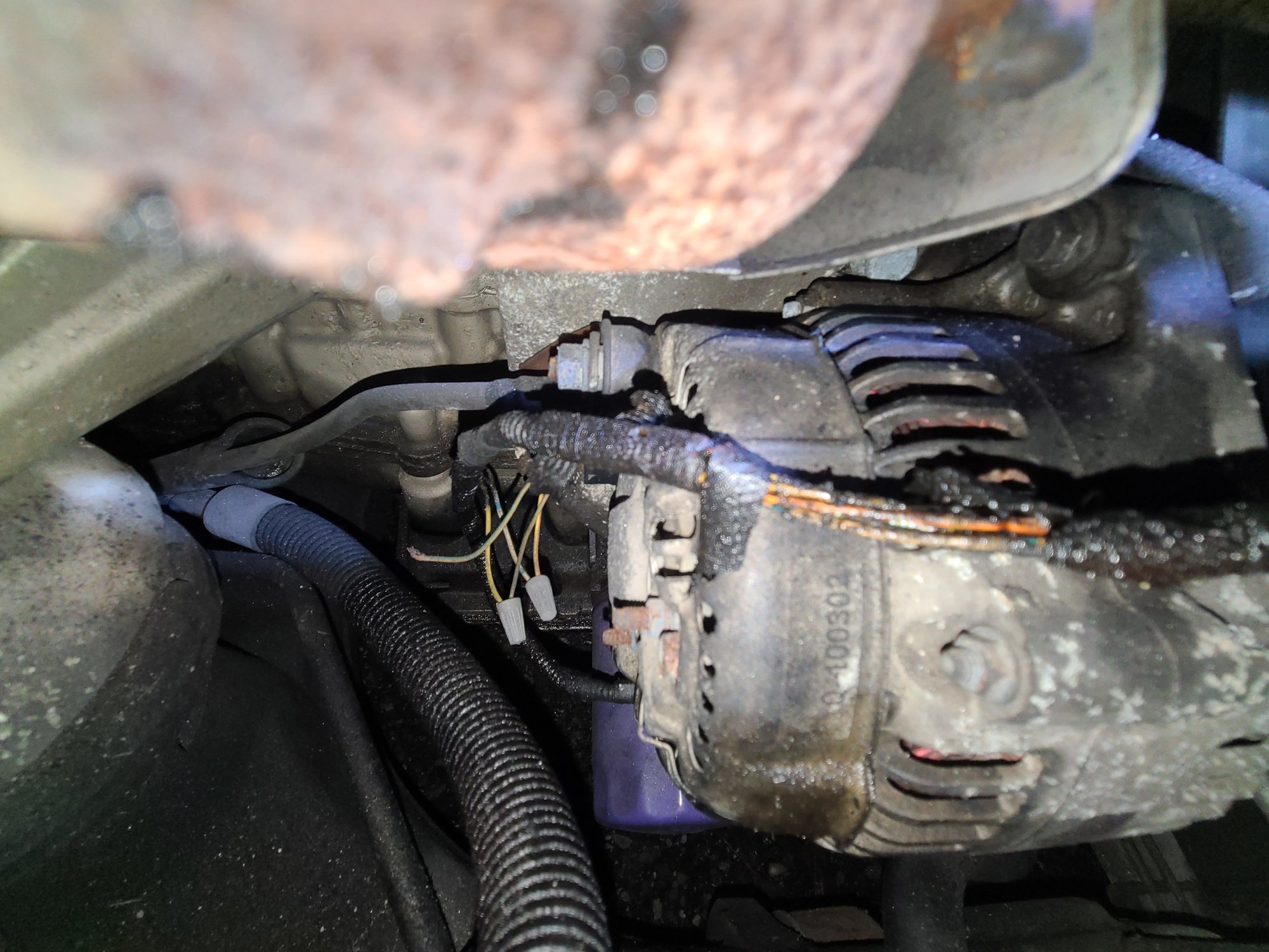

Currently at the moment the car has a faulty alternator which the last guy put in from a car at a junk yard (xj8) which is cause some more in fluxes currently have the alt on order.

I purchased a new 120amp alternator for the xk8 01 with what looks like the correct connector.

PS: there have been numerous instances reported on this forum of alternator issues when a non OEM unit is tried, having the right connector doesn’t help. Many have just had their original alternator rebuilt. Which can be a money saver too.

Unlucky for me, the guy who had the car last tried to install a non OEM one because he was in a hurry on a road trip with a random mechanic that had a junk yard tried to fit a two pin to the three pin system on the xk8 alternator plug. It really upset me to see this as now I gotta rewire this and hope the original wires are still here to redo and reverse what the mechanic did
If you cringe, I damn near threw up. It's mutual. Some how the car runs fine, but the dash is a Christmas tree

Ugh ! Wire nuts are home wiring parts, not automotive.

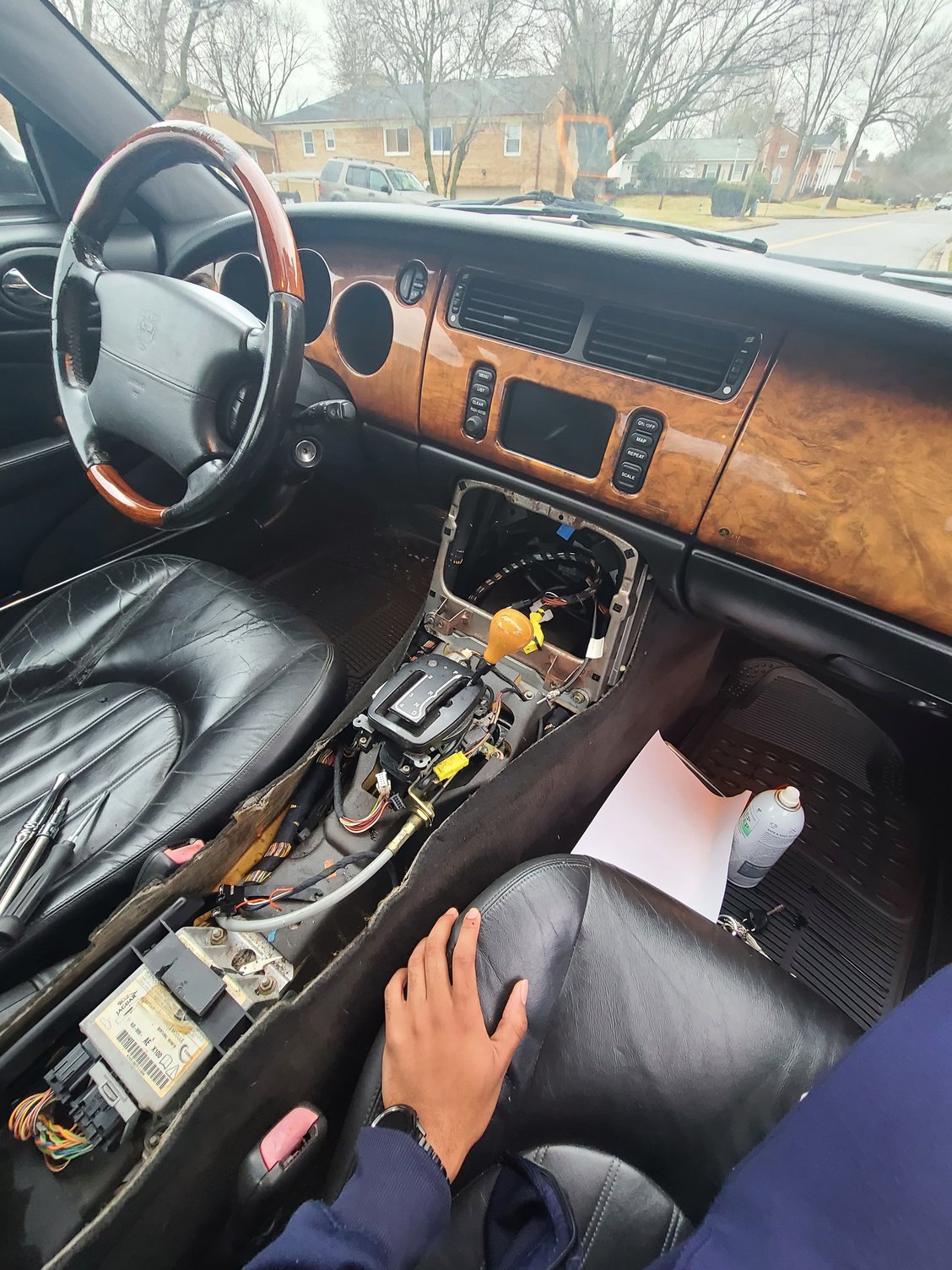

Update: It's funny looking back on when I got this car. I felt like a fool listening to the guy who sold me the car, the only real thing he was right about was the engine work but the car needed literally everything else. And so far Ive completed 80% of the work on my own and with the help of forums.

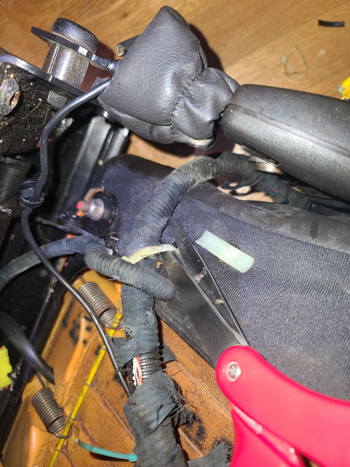

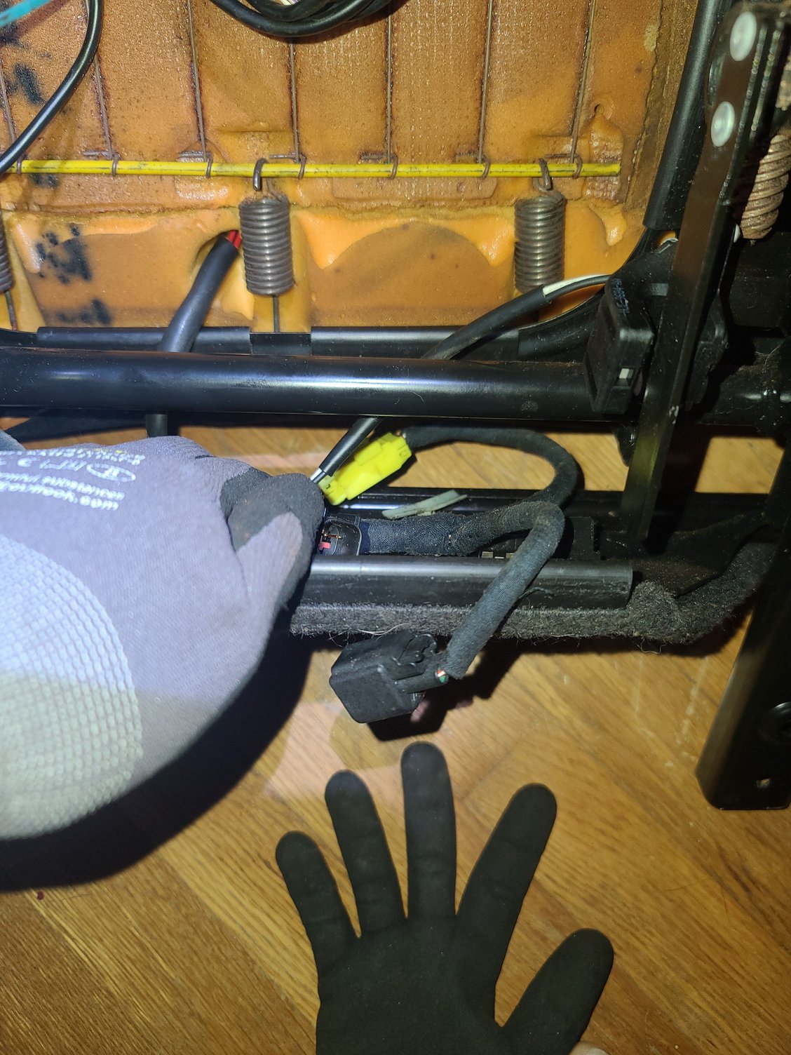

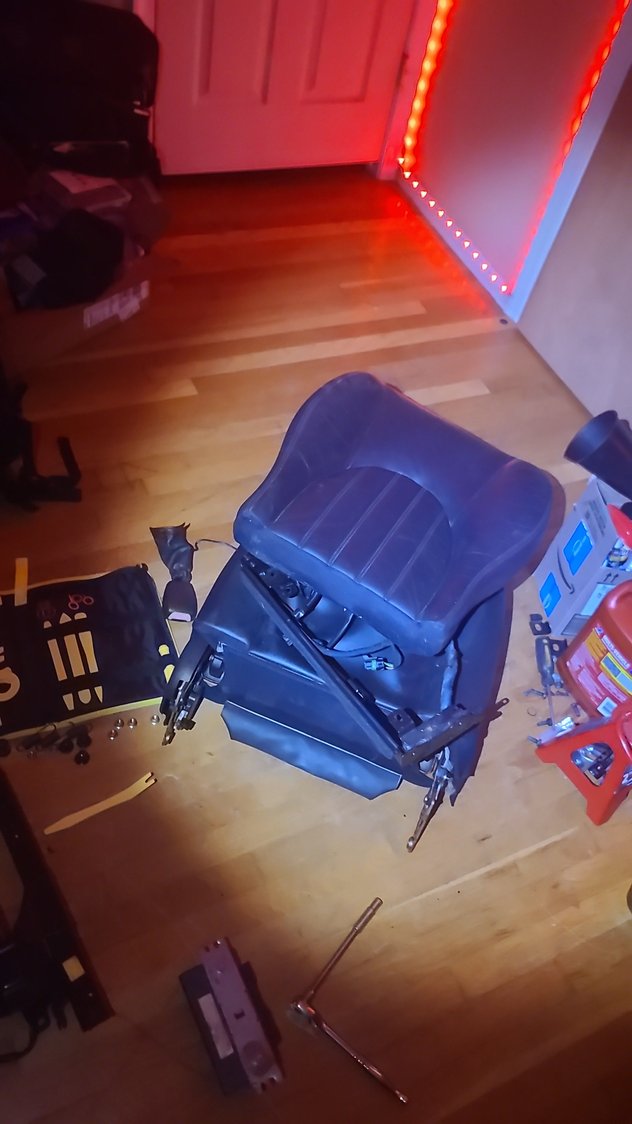

As for the chair, for 1. The fuse was blown. 2. The fuse was blown BECAUSE the module was fried. The only working thing was the motor to move the chair back and forth like the passenger chair. After a trip to a few junkyards, I found chairs out of a 100k mile xk convertible. I then used the driver chair and mine, to make 1 perfect chair.
In the process Inspected the module and yup, it was fried, in both the recline and headrest part of the circuit. Could also have been bad motors
After rebuilding everything worked besides the head rest, which I can careless for. I'm just glad I don't have to use a pillow anymore for my back
So much work as been done to this car and only more to come including u joints now. Here's some pics from my chair job
