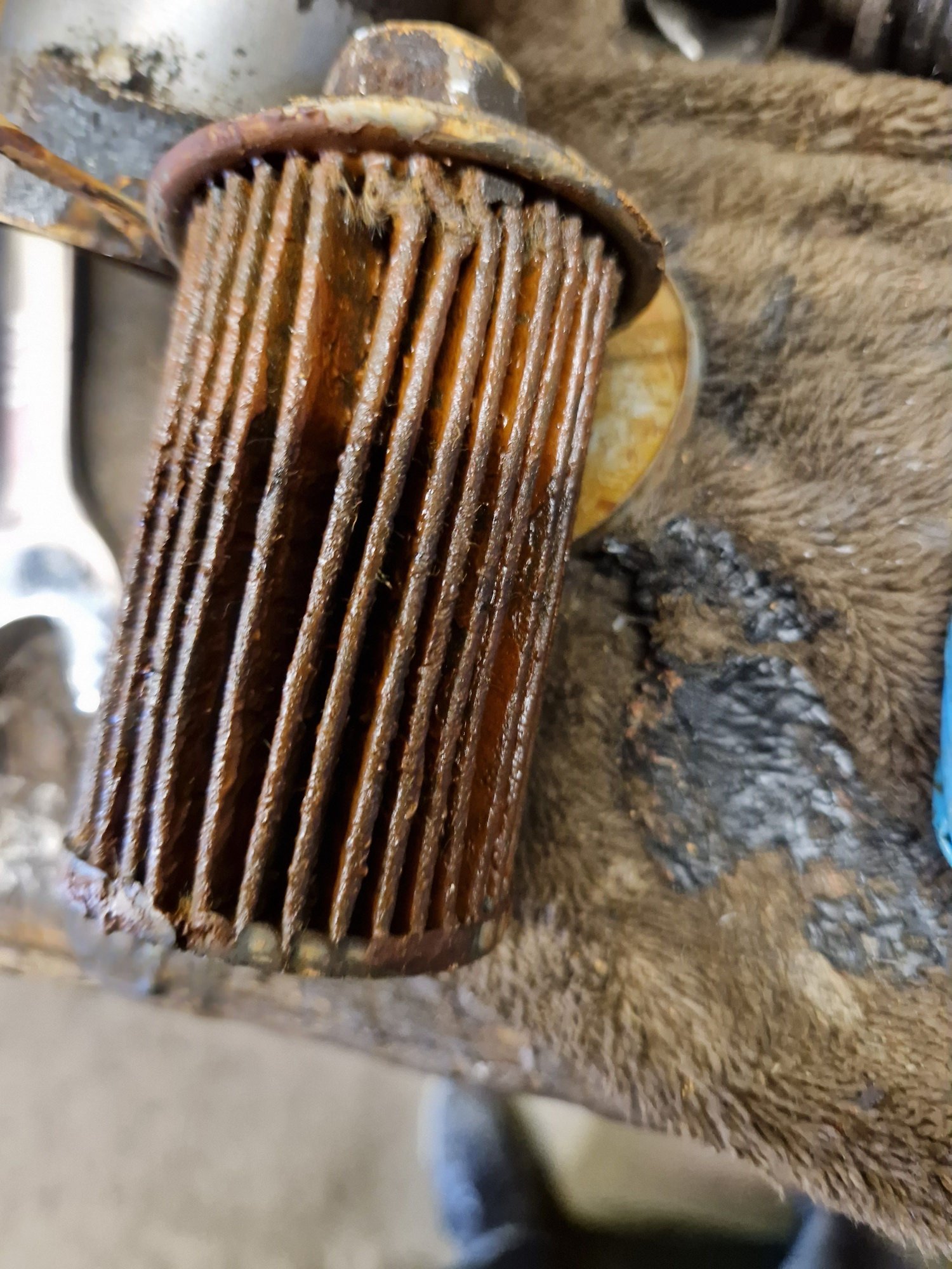

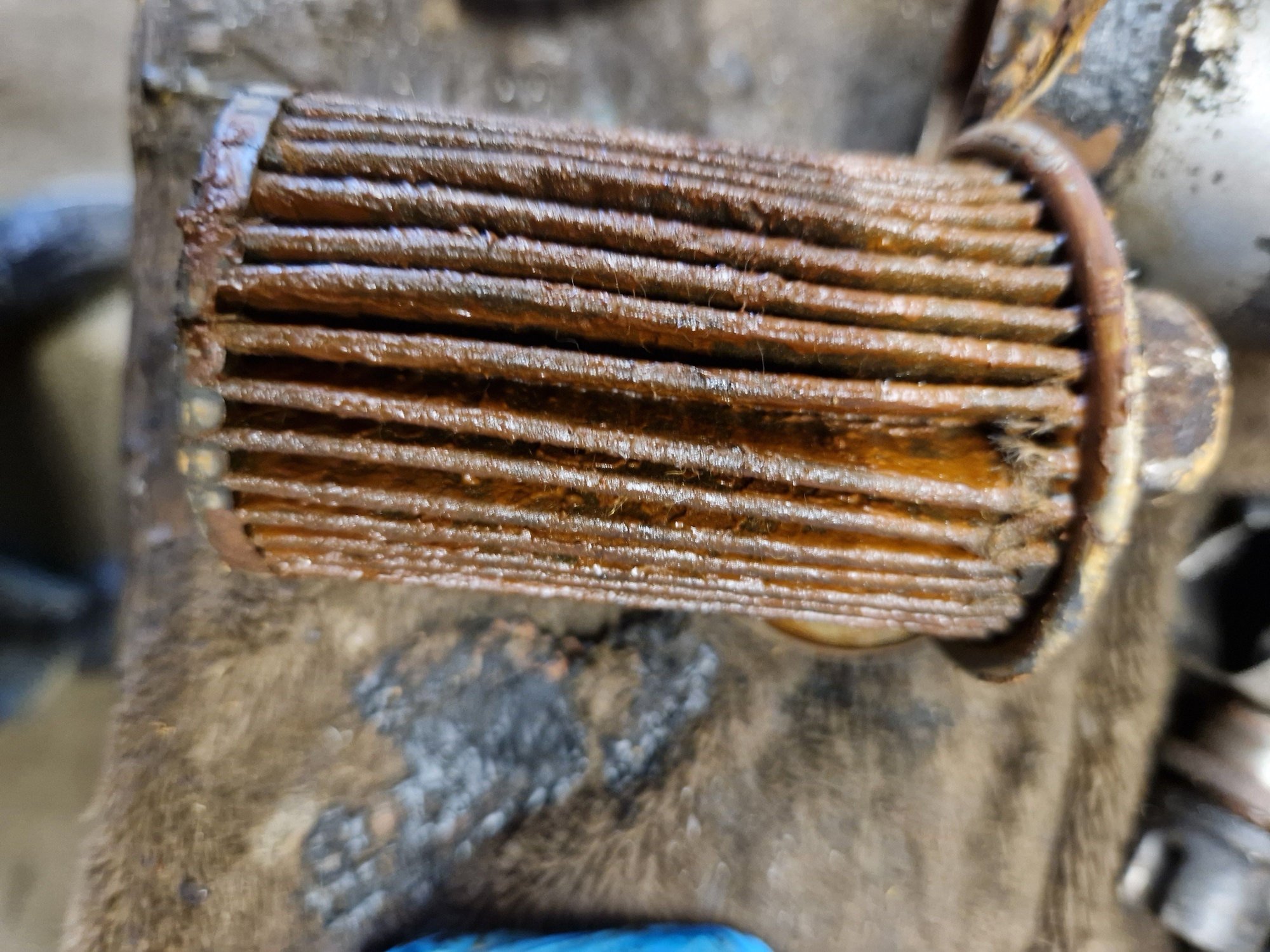

Hi and good evening thankyou for your reply. I have changed the fuel filter.
here's the old one , it was ready I think! I know about the r3v limiter and it revs ok when stood upto about 2700 then starts bouncing. Brake wise the only part not replaced was the front discs. I think i will replace them just for peace of mind. The guy had the fuel pumps done to get the car running aga8n for sale. As you correctly identified they were dead. If both were done I don't know. The car had the head gaskets done less than 2000 miles before it got parked by a specialist and other works. I will check the receipts tomorrow.

With the condition of the filter I would get a fuel pressure reading. I would also pull your new fuel filter and take a look. Might have more stuff in it. Pretty cheap to sacrifice a filter to be sure.

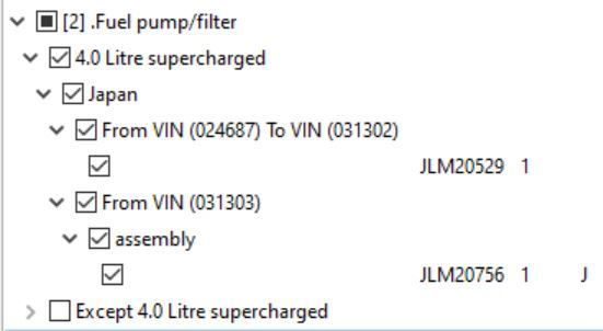

Since you have an XKR the pumps are different from the NA versions so I wonder if the correct pump was installed?
Jaguar uses the last 6 digits of the VIN to determine the right parts. You did not post that so I am not sure which pump is needed?
See if you can get a fuel pressure measurement.
