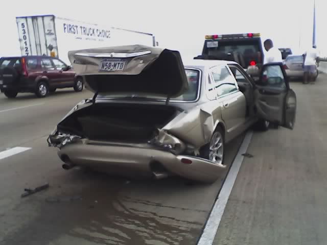

lol no problem... I bought my wife a 98 XJ8 2 years ago with 31k on it that Ive worked on and maintained since new. It even still smelled new.. until some teenager on her cell plowed into my wife at 70...never hit her brakes....knocked her into the car in front of her and totalled all 3 cars. but at least everyone walked away... Hit so hard the rear mufflers where driven through the tires and wheels locking them up..But you could open all the doors, and the cabin section wasnt even damaged.....Jags are great cars

That's a wicked hit, and I agree with you entirely aboutoccupant safety. It's always a relief to see Jags like this and everybody walking away.

Wow, the car looks amazing given the speed of the car that hit it. Glad everybody walked away
from it. That's amazing!
