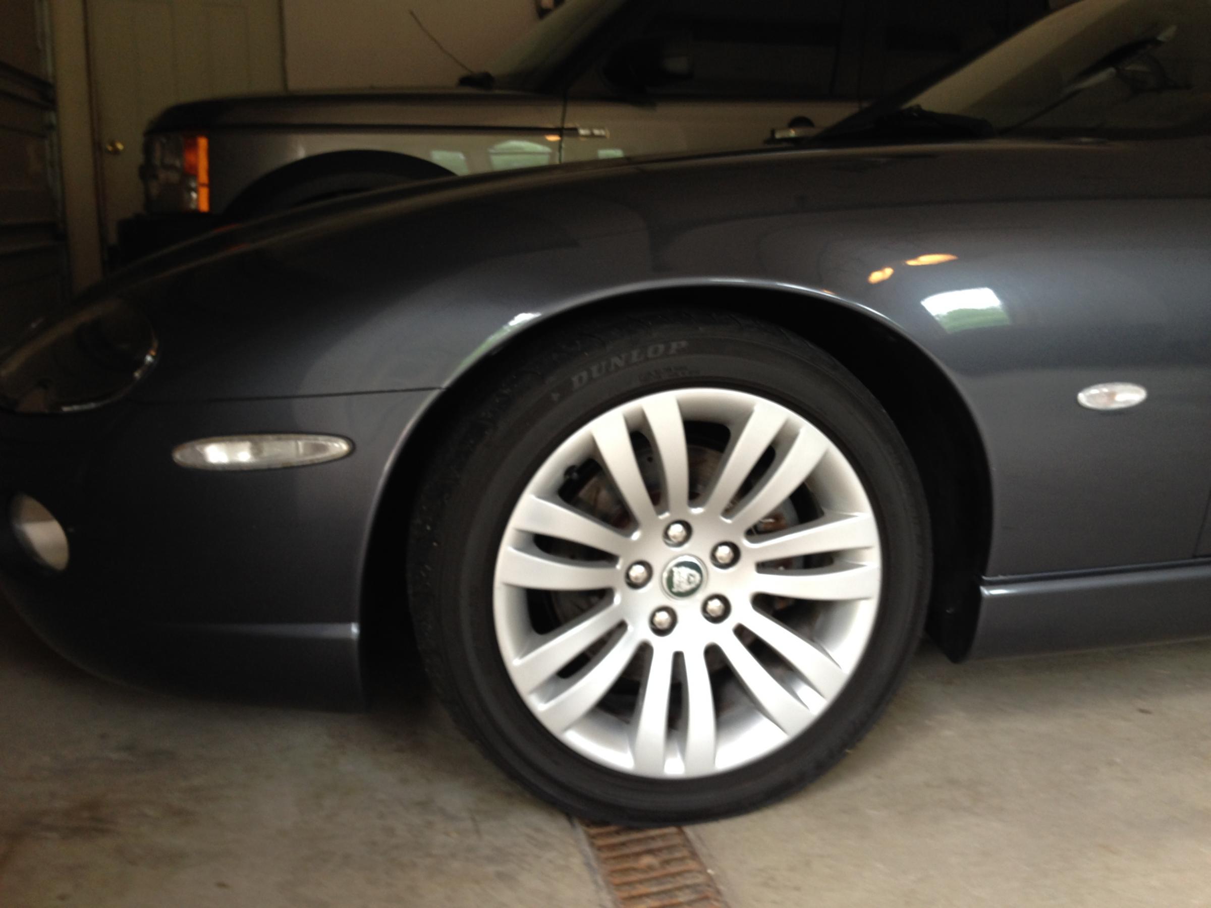

Hello all, thought I'd take a moment to post a pic of my 05 (Slate is the exterior color) with my newly fitted clear indicators and reflectors. I know many of you have done this already, but I haven't come across one in my color yet so I thought it might be beneficial for anyone considering doing the project. Had them sitting around since the winter months and finally got around to installing them. Quick and easy, and doing away with the amber really updates the car IMO. Makes it a little sportier too.
Side note, I also fitted clear indicators on my LR3 (Stornoway Gray) that are barely visible in the background. Unlike with the XKs, the clear side indicators were OEM on the last year of the LR3 ('09) and on all LR4s.
Installing upper and lower mesh grilles from Mina, WhiteXKR's triple gauge conversion, an all-leather wheel, and fitting Atlas style 19" staggered alloys w/ black center caps are next. All in my garage... just waiting for some free time. Also will be receiving a thorough detailing this weekend.

I purchased them both from eBay seller 8ru. Adamesh offers clear side reflectors and indicators as well; however, I've heard from others that they aren't a very good fit as they don't follow the curvature of the OEM amber lenses.

Awesome! I think they look especially good on the darker cars. On my car, the rear OEM reflectors are red. I personally like the red in back with the tail lights better than the clear, but it's just a personal preference. I think some of the cars were fitted with Amber in the rear; if that was the case on my car, I'd probably still try and find red ones instead of clear.

Indeed you can. Just be careful when you're taking them in and out if you haven't before. The clips are more stubborn than on the side indicators for some reason; one of mine got bent and it was almost impossible to get out. Make sure to post some pics when you're done!

I used superglue of some sort I had in the garage.. I don't remember the brand. If you go and buy some, look for 2 things. First, make sure it dries clear. Mine didn't, so if you get up close you can see the glue a little. Second, make sure it forms a waterproof seal (mine mentioned this on the packaging). I let them dry overnight before putting them back on the car just to be safe.
