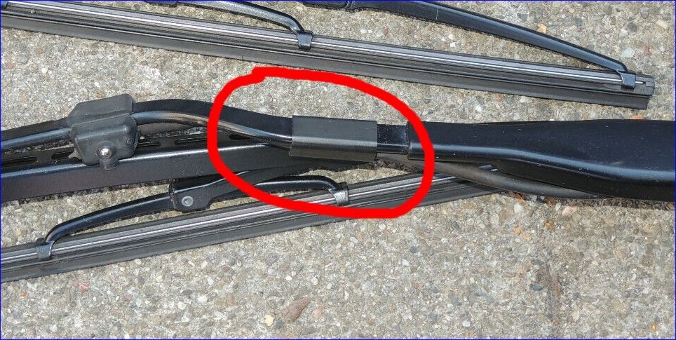

Does anyone know the part number for the plastic clip that holds the washer hose to the driver's side wiper arm? Mine cracked and fell off, leaving the hose blowing in the wind at speed...
Looking at the diagrams on the EPC, I can't see the part.
The attached photo (not mine) shows the clip (in the red circle)
Thanks,
Steve

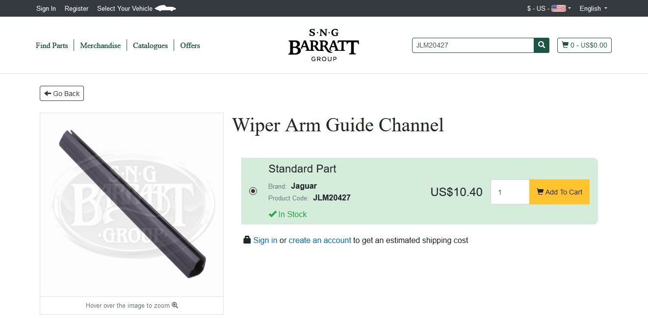

Is it Wiper Arm Guide Channel?

Thanks - it looks like that is it - hadn't realized it came as a section to cut down. I've just ordered one, but I guess I'll have enough to do 6 or 7 other cars!
-Steve
Old Jun 8, 2020 | 08:44 AM
Likes: 17,016
Not often Jaguar are that generous!
