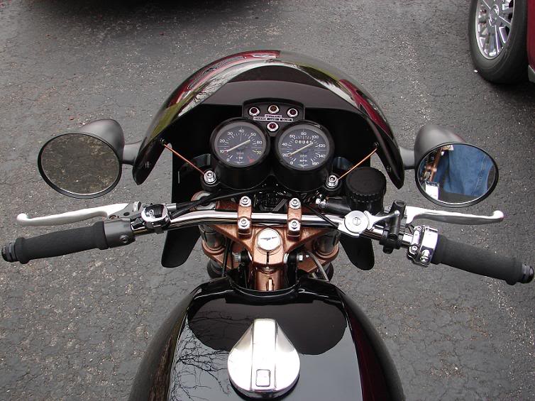

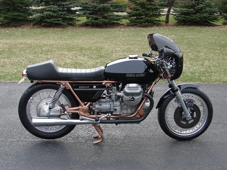

@Cat herder, let's see your 1974 Moto Guzzi 850T Cafe Racer please!

Happy to oblige. Full resto on an old basket case. A winter project that was a good alternative to therapy. It's like riding a really fast steam locomotive. Enjoy!
