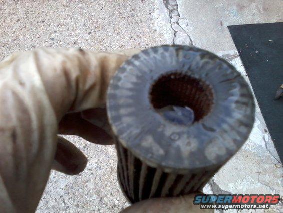

First of all, if you have a fuel filter that has never been changed, do it now!
As yo can see, the stock oem filter has no built in bypass valve, it has over 90k mile on it, and so clogged I could barely blow through it.
This will cause fuel pump failure, hard starts, and the regulator valve in trunk to come off, requiring tank removal=sucks ! !
NO BYPASS VALVE, FILTER ELEMENT GLUED -PERMANENTLY.
NO FUEL WOULD EVEN COME OUT, NOT ONE, DRIP ! IMAGINE YOUR FUEL PUMP
STRUGGLING

Thanks for the very compelling evidence. I admit that I have rarely changed fuel filters during the past ten years because the general perception is that today's fuels are much cleaner and do not tend to clog up and destroy the filters as they did decades ago....
I changed our 2005 S-Type's fuel filter at 60,000 miles a couple of years ago simply because I happened to see a Purolator fuel filter sale in a local auto parts store so I purchased one. I have not changed my wife's 2006 XK8's fuel filter yet (now at 72,400 miles). You have convinced me to do so....

What interesting, I noticed very intriguing YOU ALL NEED TO KNOW, something doing a fuel pressure test.The OEM FILTER IS FROM THE UNITED KINGDOM, it will say it
1.My fuel pressure would continue to climb with the KEY OFF.
Why -the filter was clogged and after the key was off, the fuel came through in a SURGE.
2.My fuel pressure was normal 42lbs.
3.Once the fuel pressure gauge was put on the windshield to monitor inside the car, while turning the key forward, I noticed the pressure climb from 0-42psi a little slow/skimpy.One time it hung at 39, then jumped to 42.
4.Suspecting my gauge was faulty, I monitored pressure on a car with a new filter, and did not have these results.
This concluded I had a fuel pump issue,so my first inspection is the filter, and bam, the first inspection failed.
