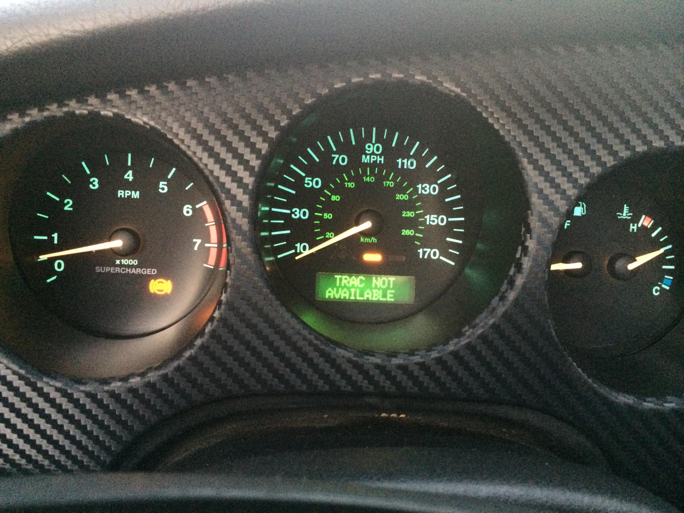

HArd reset is when I disconnect battery and keep neg and pos wires connected for 30 seconds or so correct? Currently there are no codes but the ABS light and amber light are still on.
Perhaps buying an xkr project was a bit to much for me at the moment!
Im used to problem child vehicles it adds to the excitement of ownership..But this is getting ridiculous:O)

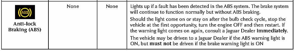

If the Amber light is the actual MIL/CEL light Then what was that other orange thing that looked like an engine that was orange called? It turned off when I cleared the codes and hasnt come back on. Im doing my best here to read up on as much as I can but the search engine for the forum seems to not be faring well for me.
MANY THANKS!

The engine shaped orange signal is the CEL/MIL. Don't know what other light you are referring to. Maybe my car has just been too well behaved.

ABS modual will be coming out ASAP. Easy enough and likely is an issue based on what Ive bene reading up on.
Now This amber light

Default ABS Light
Originally Posted by XxSlowpokexX
ABS module will be coming out ASAP. Easy enough and likely is an issue based on what Ive bene reading up on.
Abs Light
