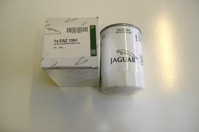

Old Mar 29, 2013 | 07:36 PM
Likes: 17,016
Originally Posted by Bigvettefreak
.................. What is considered the correct filter to use on my car? Mobil 1? Bosh? wix? .........
The correct Oil Filter for your vehicle is:
It is manufactured for Jaguar to their specification.
There are many alternative brands that will fit. They say so in the catalogue or on the box. What I have yet to see on an alternative brand is the phrase 'to Jaguar specification'. There's a big difference between fit and specification.
On most parts you can see the quality. With an Oil Filter, there's no way of knowing what's inside without cutting it open.
With a scheduled oil and filter change interval of 12K Miles or 12 Months, the cost of the fuel I burn makes any consideration of saving on filters irrelevant. Jaguar OE for me every time.

Old Mar 29, 2013 | 09:01 PM
Jag#4's Avatar
Joined: Feb 2012
Posts: 2,997
Likes: 714
From: Waco, Texas, US
+1 on Graham's comment. Use the OE filter. Cheap insurance. I changed mine today. $20 USD at the dealer including tax and a free bottled water.
