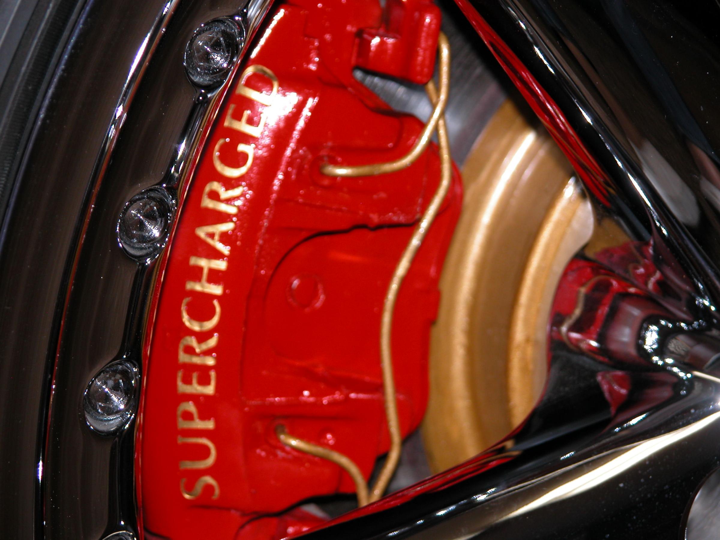

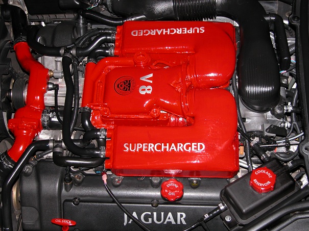

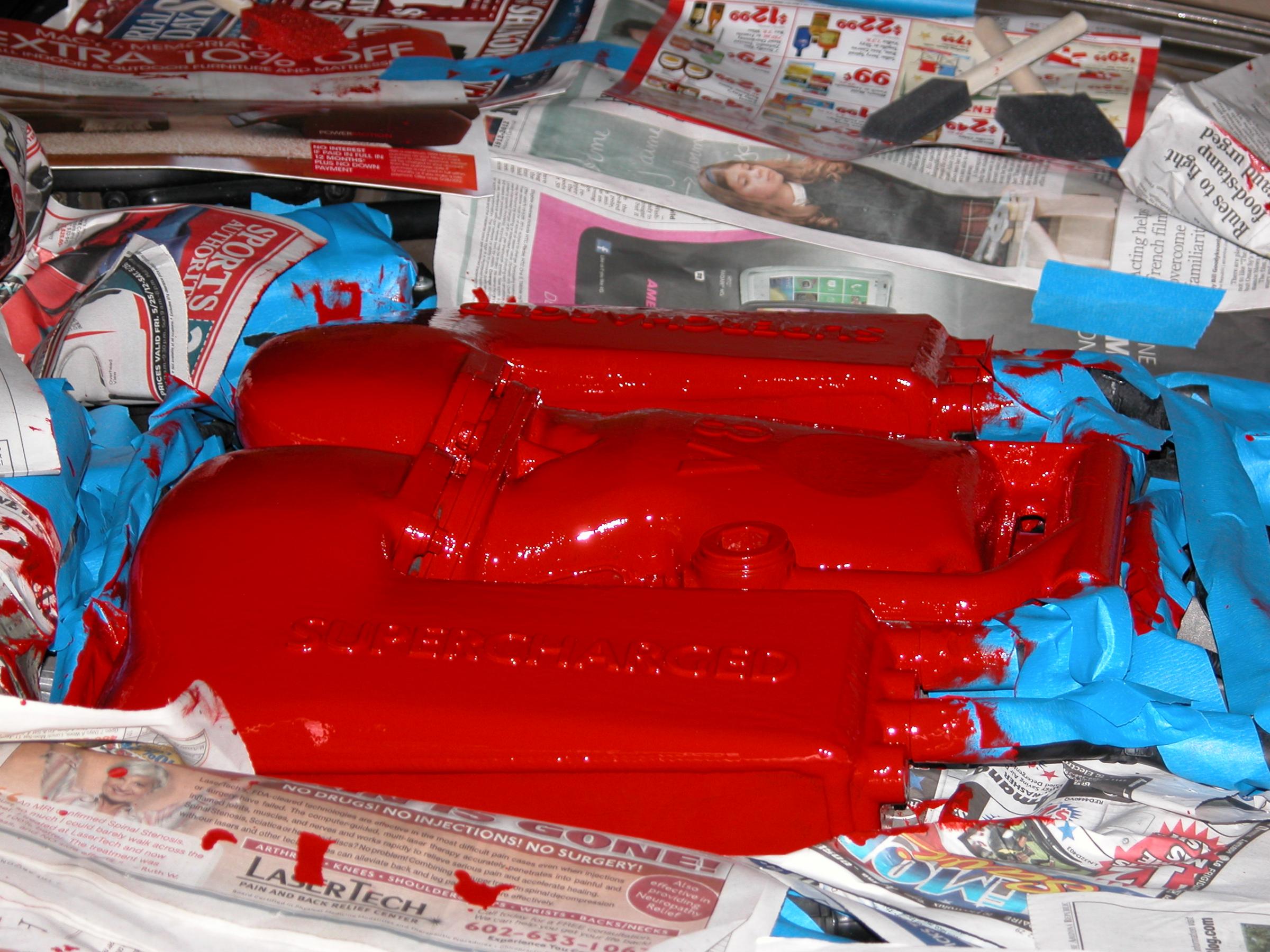

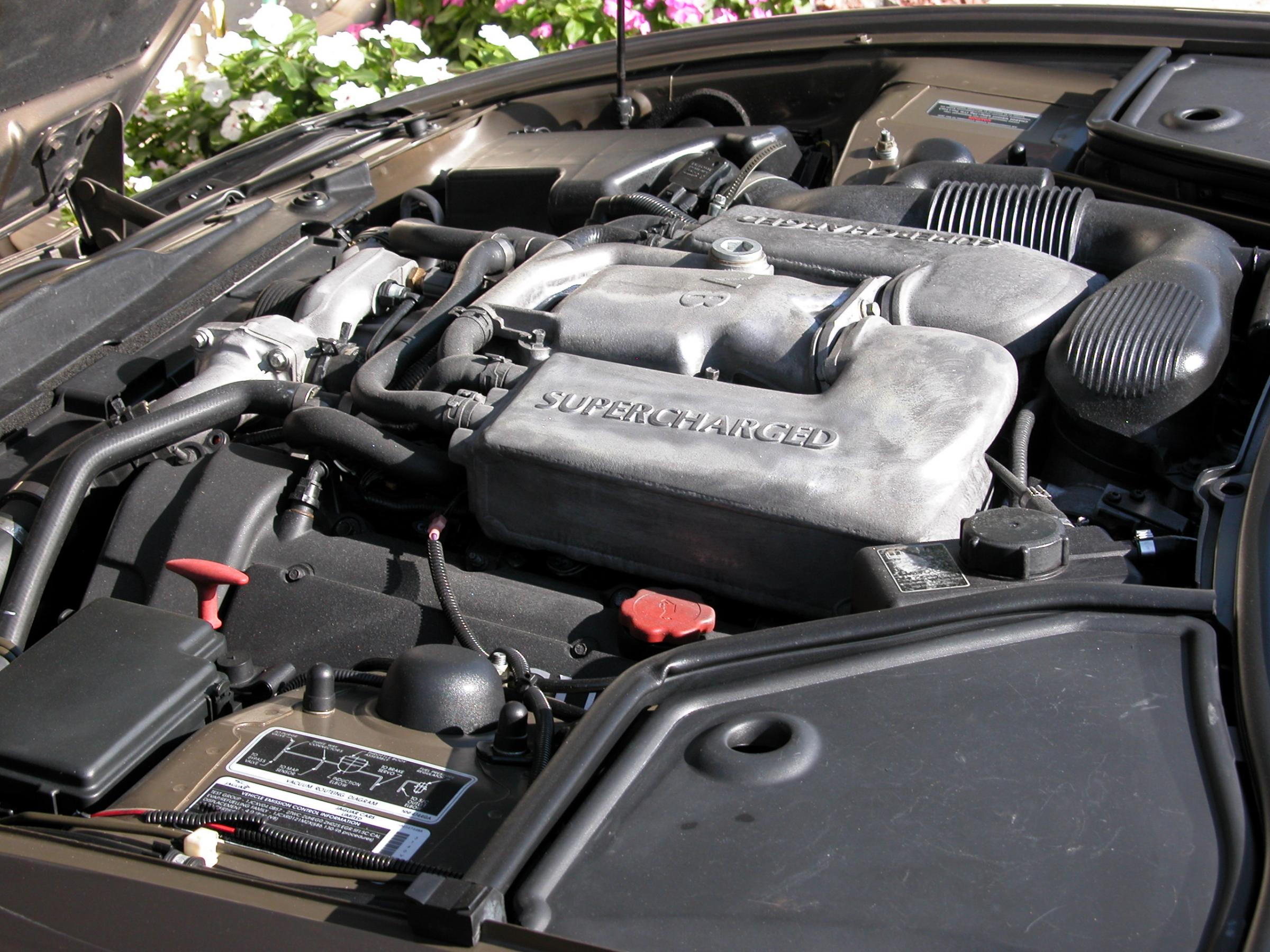

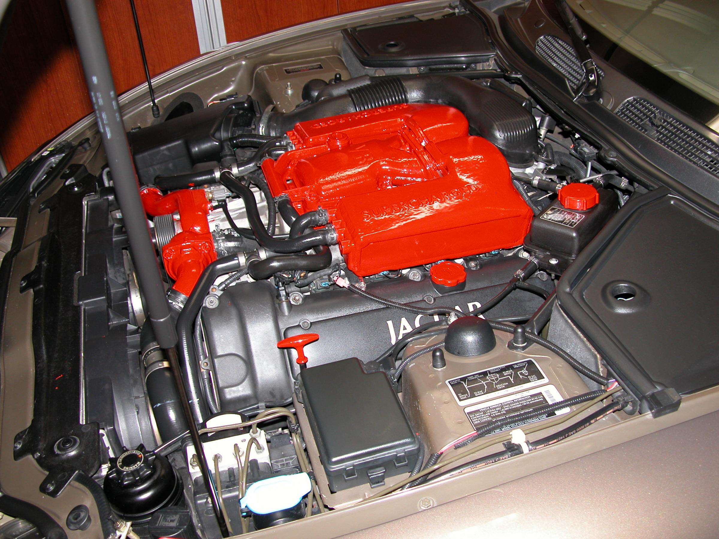

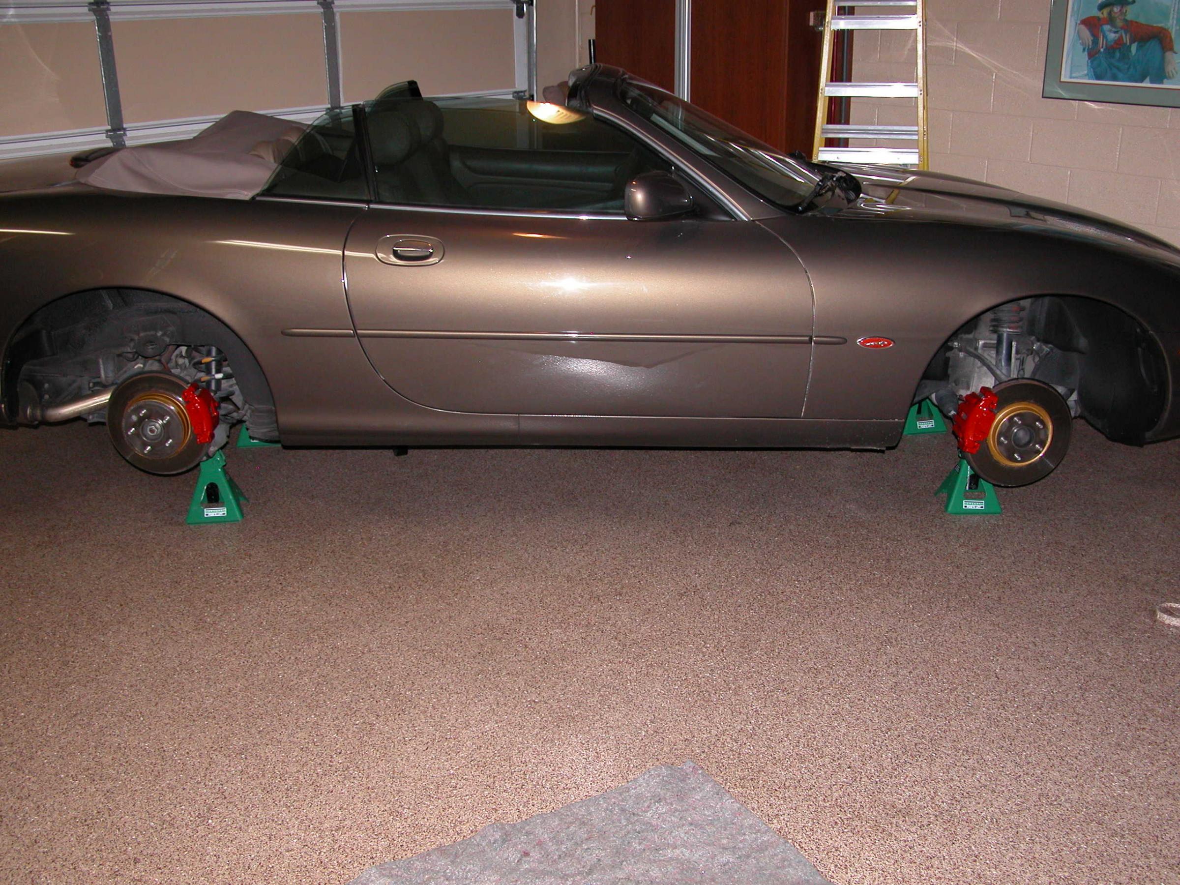

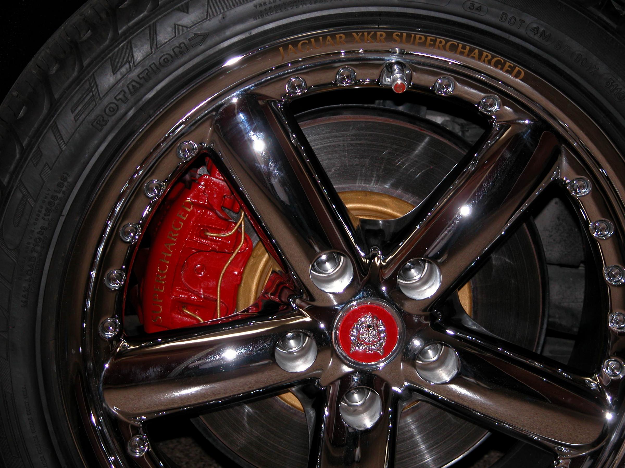

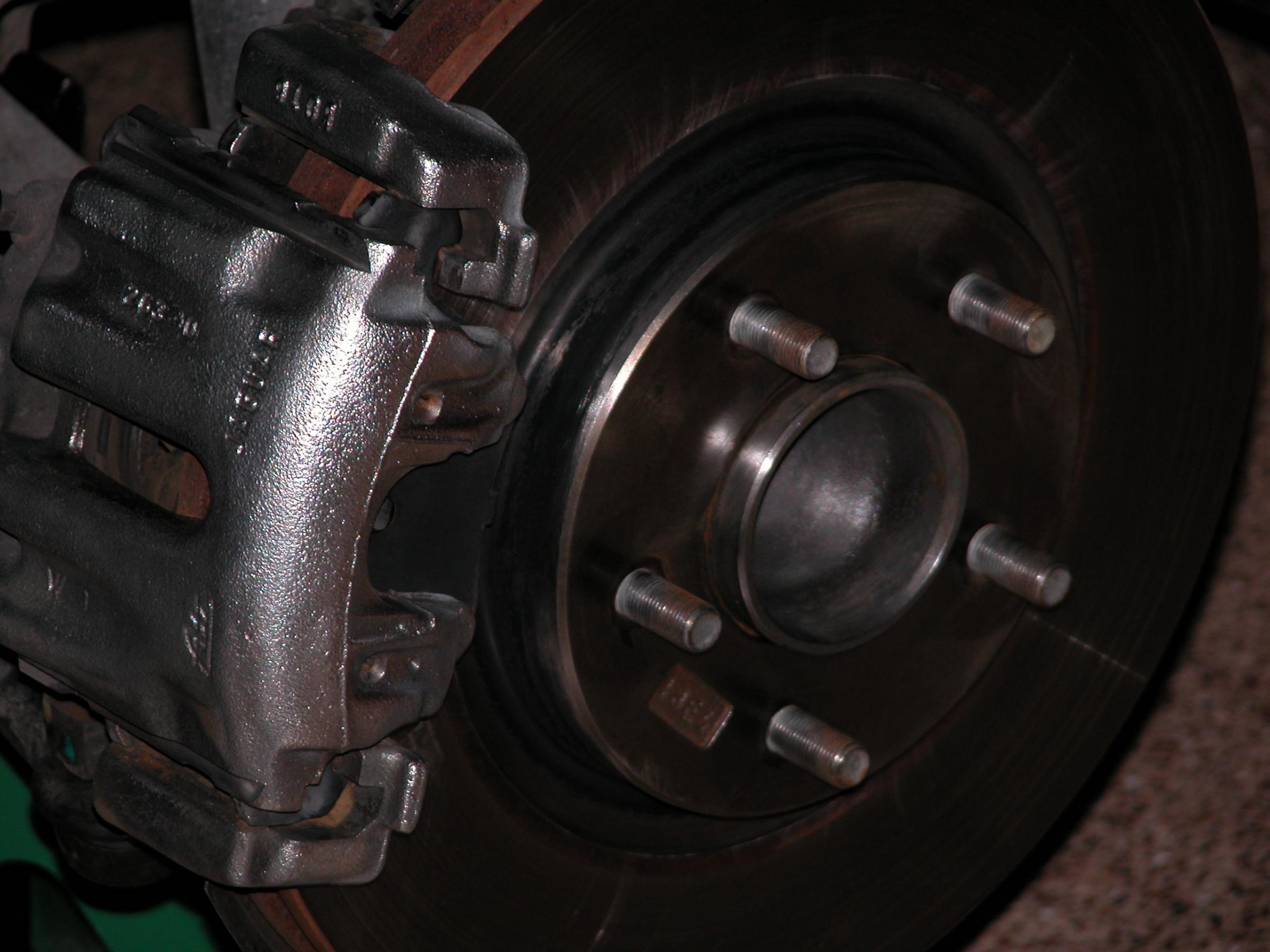

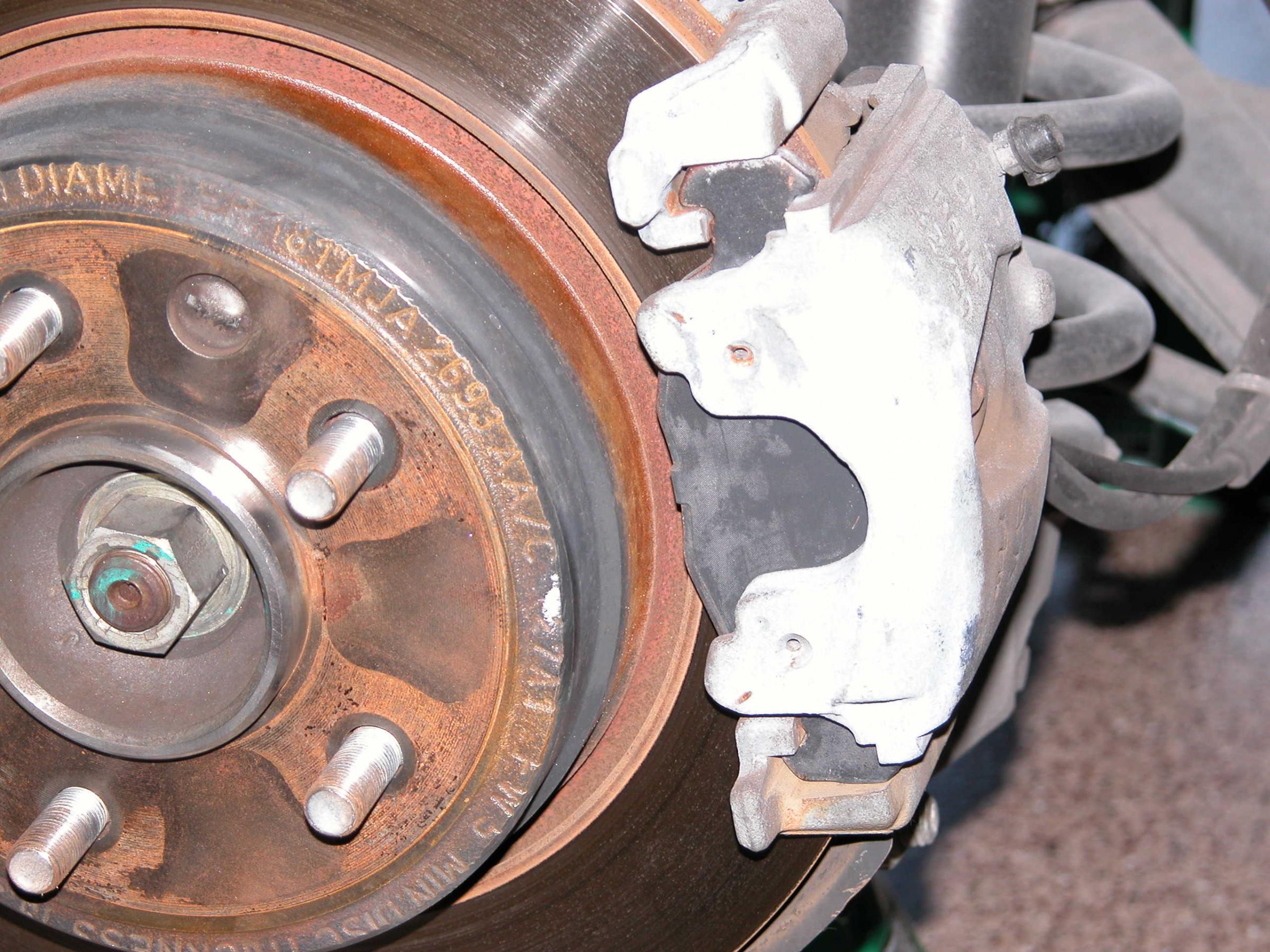

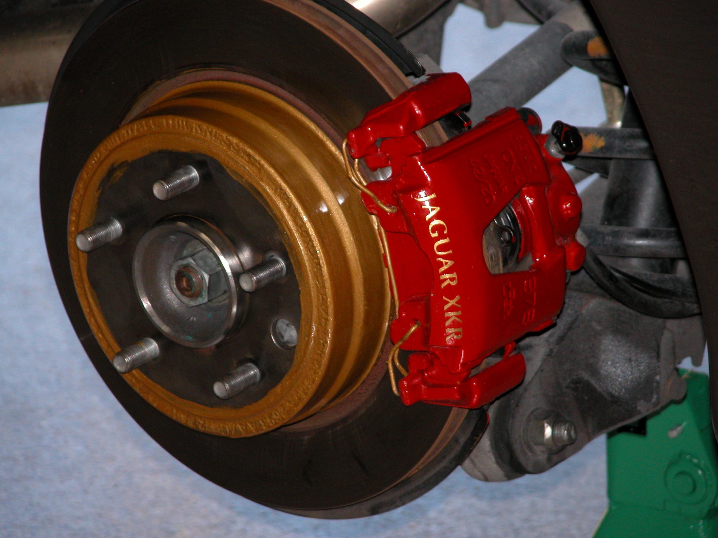

Here you go.
I did my wheels about 2 years ago with the G2 high temp paint, I also did the engine and supercharger.
The prep is the biggest deal of all, must get wheels and engine clean and rust and grease free not hard just some elbow grease.
They look as good today as the day they were painted. I used 2 cans for the 4 wheels, 2 for the engine and 1 gold for the hubs.
Big bang for the buck, 100 of them total.
Took 2 days had to let them dry over night.
Jacked up the car, removed the wheels and painted the calipers right on the car. Put decals on and sprayed with clear coat.
Have fun, it's a good project.
And remember
Happy Motoring...
Attached Thumbnails colored calipers-dscn2072.jpg   colored calipers-dscn2078.jpg   colored calipers-dscn2084.jpg   colored calipers-dscn2087.jpg   colored calipers-dscn2102.jpg

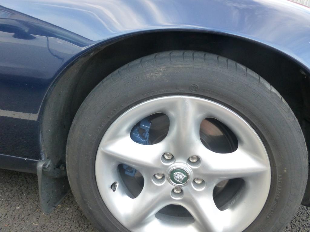

went for blue callipers to match my blue car. i used hammerite smooth blue which after one coat looked very bright so the second coat i mixed in a little black hammerite and got a pretty good match.
