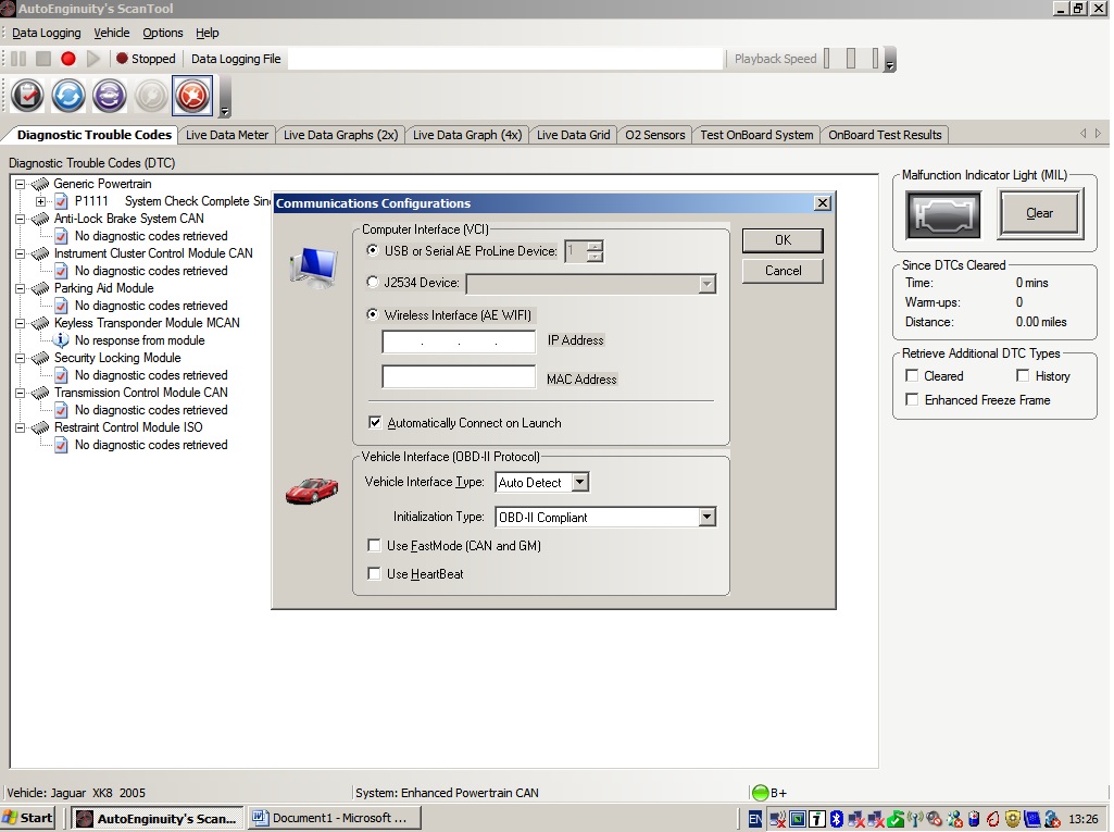

Here's the connection screen on my AutoEnginuity ProLine with Jaguar Enhancement:
As you can see, it's connecting ISO9141-2.
No need to pick this. If the configuration for Vehicle Interface Type is set to Auto Detect .......
....... it will do it all or you.
