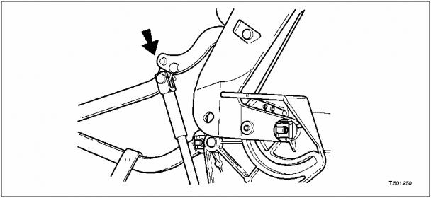

RedPopTop: in your post you said you were trying to push the rams down. If you meant that literally, that probably won't work. You have to reach inside and pull on things. Go easy here, it is possible to do damage. The picture might help.
1)Lower the rear quarter glass by pressing the rear of the 'ROOF' button once.
2)Rotate the pump valve (located in the RH side-well of the trunk) counter-clockwise to the manual operation position.
3)Remove the blanking plug from the header trim, insert the Allen key provided (stowed alongside the top pump) and unlatch the top by turning the key clockwise.
4)During Emergency lowering of Top Reaching behind the top rear quarter curtains, pull the rams and linkages at both sides firmly downwards as far as possible. (sse JTIS pictue for details)
5)Manually lower top to stowed position, if necessary repeating step 4 above.

The procedure which I posted in #10 above (this thread) came, I think, from JTIS. Can you see the photo yet? If not I'll email it to you if you want.
