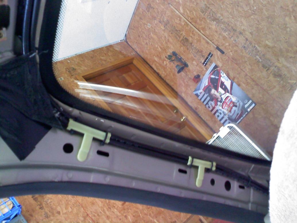

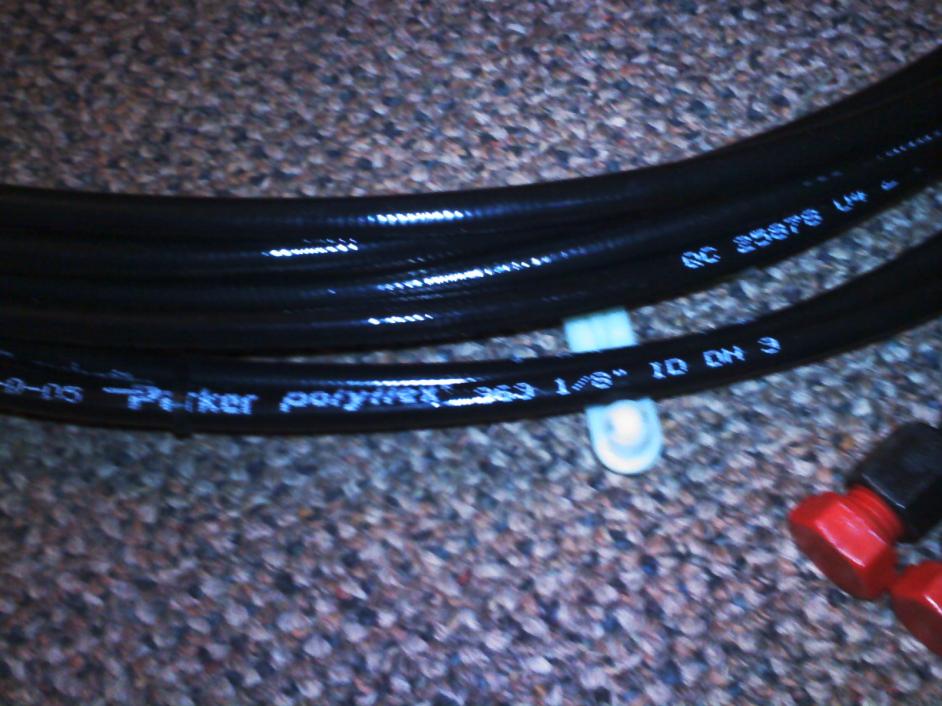

These are the hoses I received today from Welsh. I hope you guys can read the detail. There are also 2 white T clips attached, I assume these will go in the A post as I saw them in a schematic. The oil should be here in a couple days.

Yes they are the same hoses, take notice of the Parker 363 stamp on the hose. The two white clips represent the end that goes to your header latch. They snap into the “A” pillar you will see that when you remove the old one.

That question is finally answered. Those were made at the Power Packer plant in the Netherlands. Power Packer is the only source for that custom hose and the matching fittings.
At one point I was able to talk with a hose engineer at Parker US (in Ohio) who researched this for me. At the time I was looking into the possibility of a proper splice kit. He told me that the hose was made only for Power Packer and the fittings have to be made for that hose. There is no hope of doing that since Power Packer has refused to cooperate and the hose has unique dimensions. My guess is that they switched to this to make installation easier at the Jaguar factory due to the greater flexibility and smaller OD. Presumably the 363 hose is also less expensive than the original wire reinforced version.
There was an intermediated version of the 363 hose that was worse than the current version. The piece that Gus sent me is called "Nylaflow" and has date code 1-Q-00. My car is a 2000 model so it probably has this stuff from the factory but it was replaced in 2003 (according the the hose date code) when the car was in lease prior to my buying it.
Gus' hose kit is the best alternative that exists. It uses wire reinforced hose (as does the valve kit) and has a high pressure and temperature rating. Wire reinforcement does a lot to combat the fatigue that comes from small movements each time the latch operates. We have speculated that this is why the OEM hose fails at that particular spot, which is the focal point of stress related to pressure, temperature, and movement of the latch mechanism.

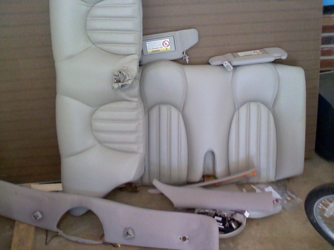

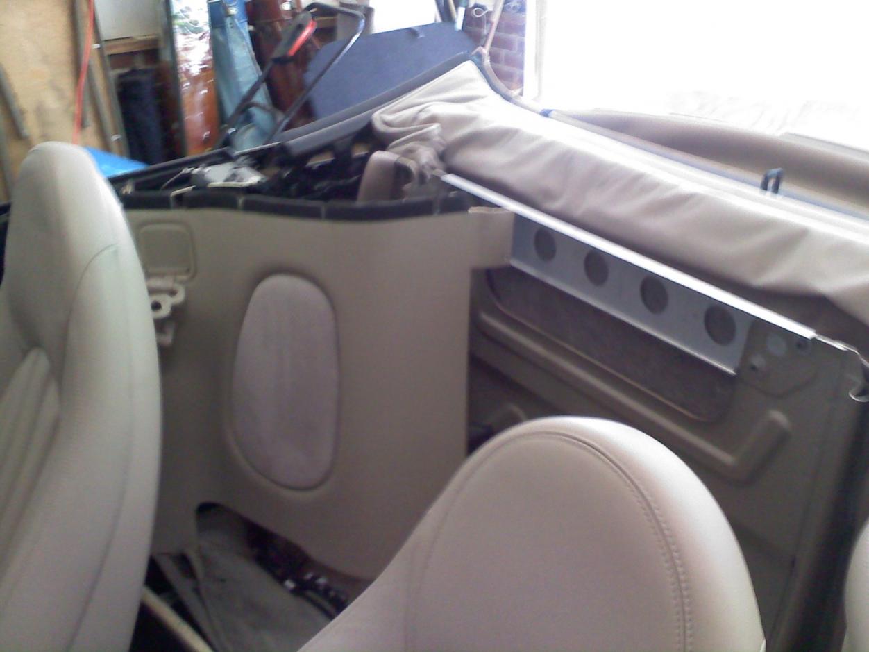

Making some progress on this job today. I've stopped for now, it's very hot in the garage, and will pick it back up tomorrow morning. This is about 4 hours of work, I'm taking my time...labeling and bagging all the screws for each section as I go along.
Manually lowered the top. Removed the back seats, right hand interior panel and cap, A post covers on both sides, overhead console and trim piece, visors, and top metal piece.
Tomorrow I'll try and remove the drivers seat (I am having a problem with removing the plastic trim on the track to get at the last bolt. Understand it's attached with double sided tape but it won't release), lower down the latch assembly, and then remove the center console.
Am I correct in that the top must be up to access the hose where it goes into the trunk? I can't see any other way to reach it.
Here are some pics. As suspected, it was leaking at one of the hose fittings connecting to the latch. The hose has a date stamp of '99, probably original to the car.
