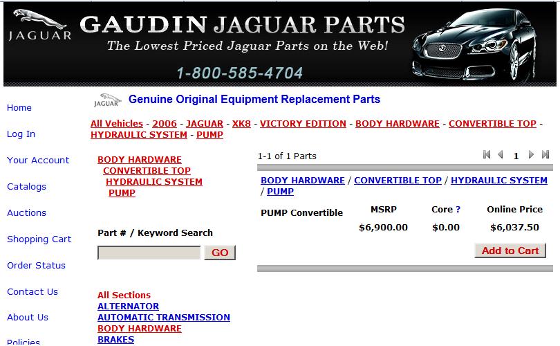

Default Thank God for aftermarket discounts!
I assume this is a decimal-point error or some such?
Old Jul 14, 2012 | 03:54 PM
  #405
Gus's Avatar
Gus
Joined: Jul 2008
Posts: 11,356
Likes: 2,234
From: Berlin Md.
Look at this Jaugar XK8 XKR Roof Pump, Hydraulic pump/Motor | eBay
