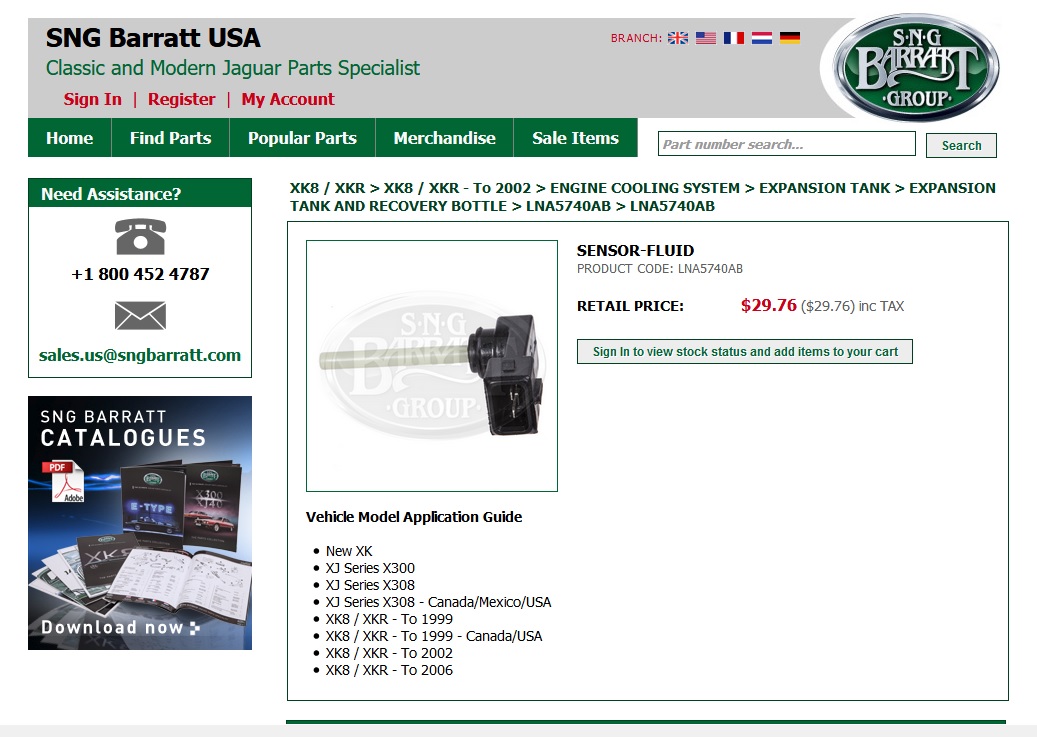

Is the Expansion Tank otherwise OK? The coolant sensor is available separately.
P/N LNA5740AB.

The sensor is not the problem. The problem is that the magnet in the float has fallen out. Without the magnet in the float the sensor will not work. In fact if not disconnected it would give a low level warning even with the tank full.
