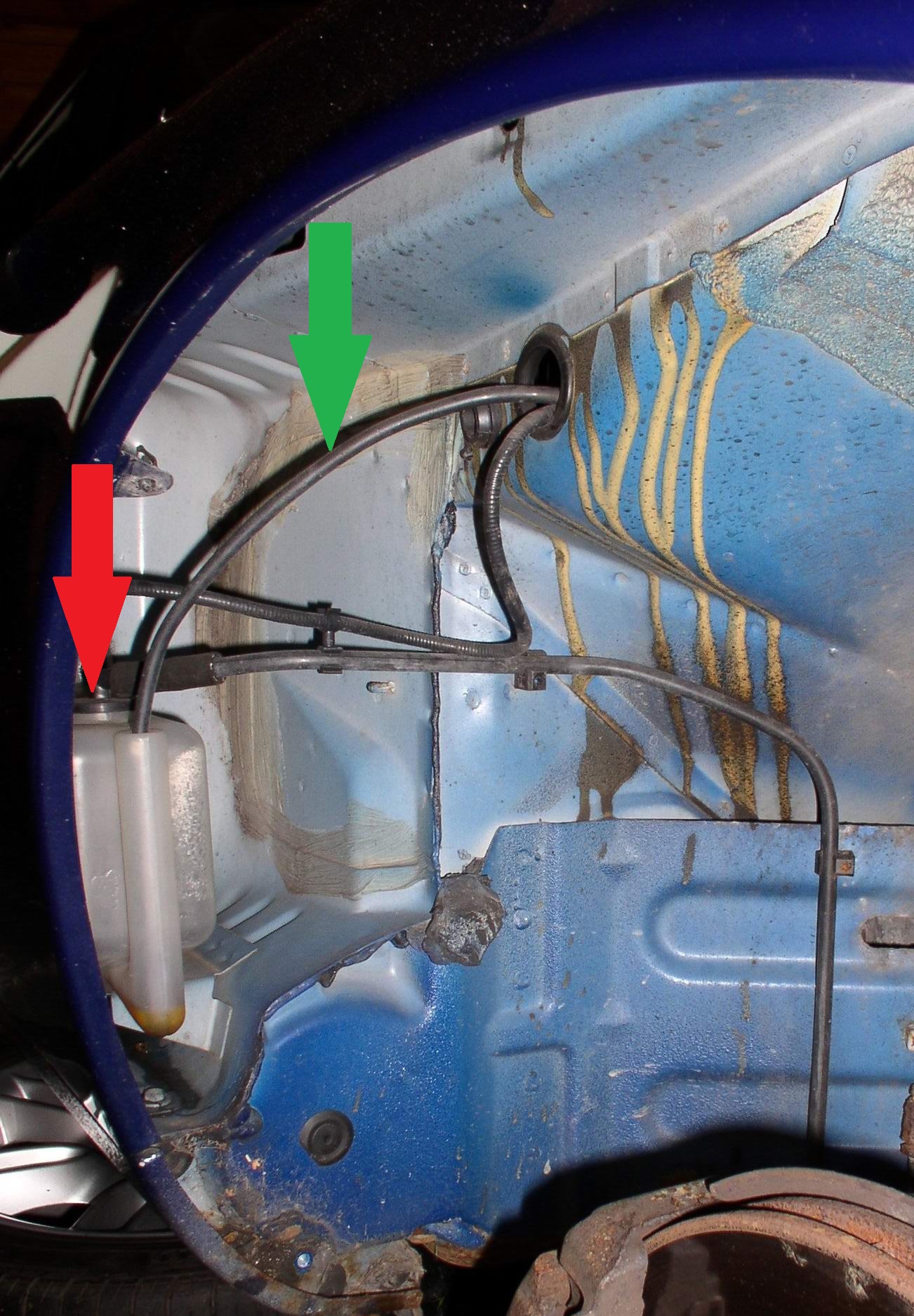

You need to remove the fender liner and inspect the overflow tank, there may be a leak.
Old Jul 9, 2015 | 12:51 PM
I've seen a few instances of the Atmospheric Recovery Bottle cap (arrowed in red) being detached:
You should also check the pipe from the Expansion Tank (arrowed in green) for integrity and that it's correctly connected to the Bottle.
