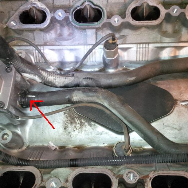

First guess is the valley hoses that run under the intake manifold. Not a real big deal but better done DIY unless you have lots of hundreds to invest in professional repair.

Common issue. This is where mine was leaking. Not a difficult repair, took me a weekend.
