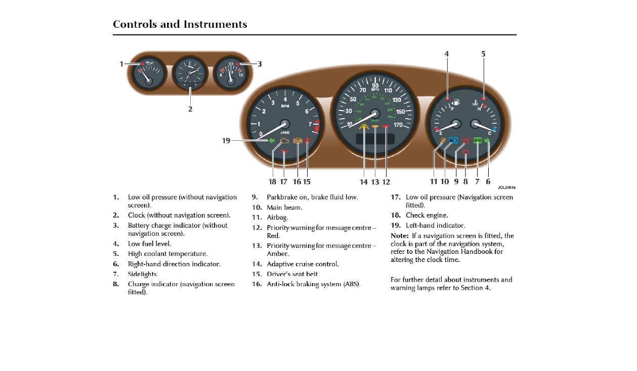

I just brought my 2003 XKR home from Maryland. I was able to disengage my emergency brake quickly due to the forum's great contributors. However, I still have a 2 beep warning (every 5 seconds) that I can't stop. Most importantly, I have had a frantic red light (whistling, clicking and flashing) intermittently going wild on the trip home 250 miles and since then. It is located at the base of the tachometer like the other two at the bases of the speedometer and fuel/heat gauges. There is no mention of them in the manual and they illicit no messages and provide no codes. If I had another option I would have stopped the car until I could figure out what was wrong. Of course, I would still be there. I have searched the forum and found some speculation , but nothing definitive.

You have 2 red icons in you tachometer assuming you have navigation. One is an oil can icon. The other is a seat belt icon. Which one is it?
Old Oct 18, 2016 | 01:14 PM
+1
Items 17 and 15:

If it is #15 that is blinking, then the Driver's side seat belt buckle connectors may be loose or damaged, or there could be a foreign object stuck in the seat belt buckle that is not allowing it to clasp completely, or is blocking the Sensor from detecting that the buckle is clasped, and is intermittently setting off the Driver's Seat Belt Warning Light and Tone. Canned Air and Electronics Cleaner, should it be something sticky, directed into the buckle and sprayed while actuating the release button on the buckle could dislodge an object, or dissolve anything sticky that may be causing the problem.
Have you had a passenger in the car before all this began, and since it has begun? I do not know if the same light will chime and blink if the passenger belt buckle is not fastened, or the buckle is jammed or not fully disengaged from the last time a passenger exited the car. The electronics may be 'confused' if the passenger buckle is being detected as clasped, but no weight is on the seat to activate the passenger air bags.

These are not icons. They are physical protruding lights at the base of the instruments. You can run your finger over them. The middle one remains green.
Old Oct 18, 2016 | 03:29 PM
sjagerson's Avatar
Posts: 54
From: Hamden, NY
Not icons, physical lights sticking up from the base of the instrument panel.
Old Oct 18, 2016 | 03:32 PM
sjagerson's Avatar
Posts: 54
From: Hamden, NY
There are no corresponding numbers for the lights I'm speaking about in the instrument panel representation in the manual. They are in front of the instrument panel glass, not behind it.
