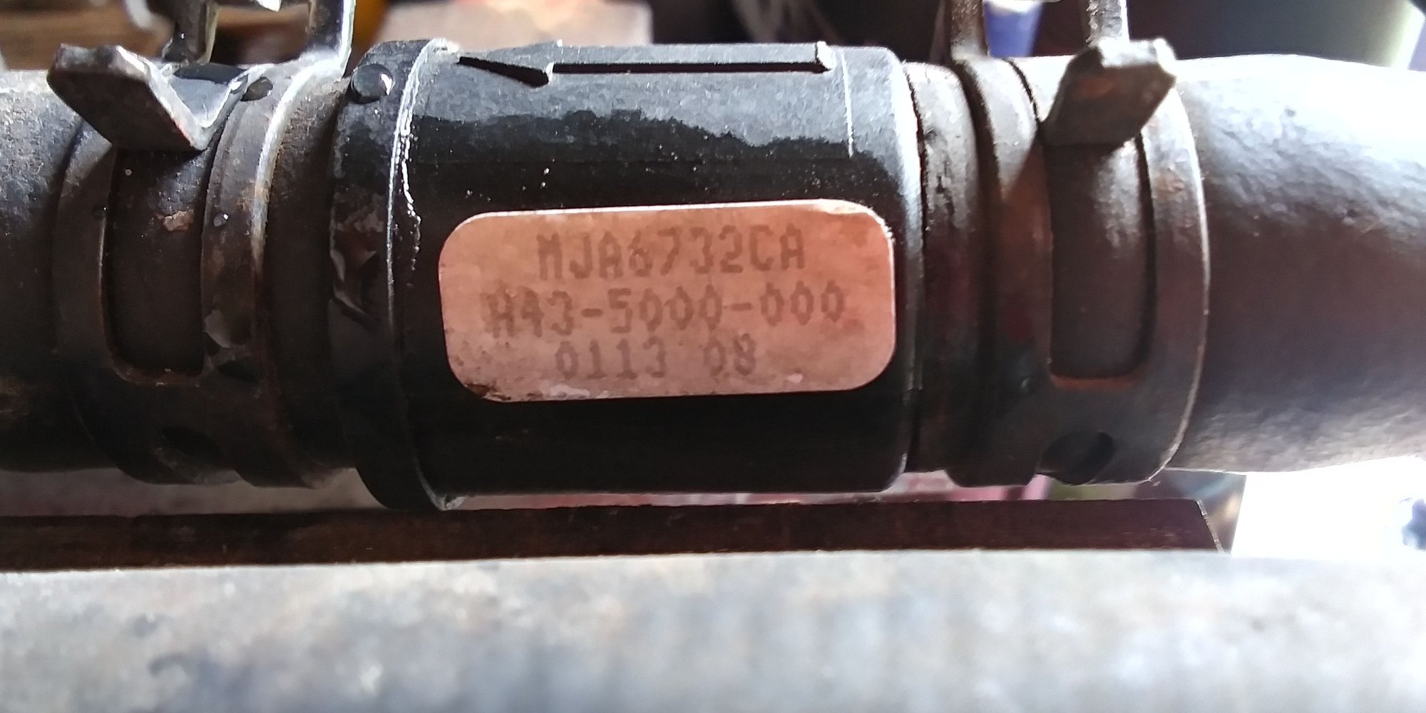

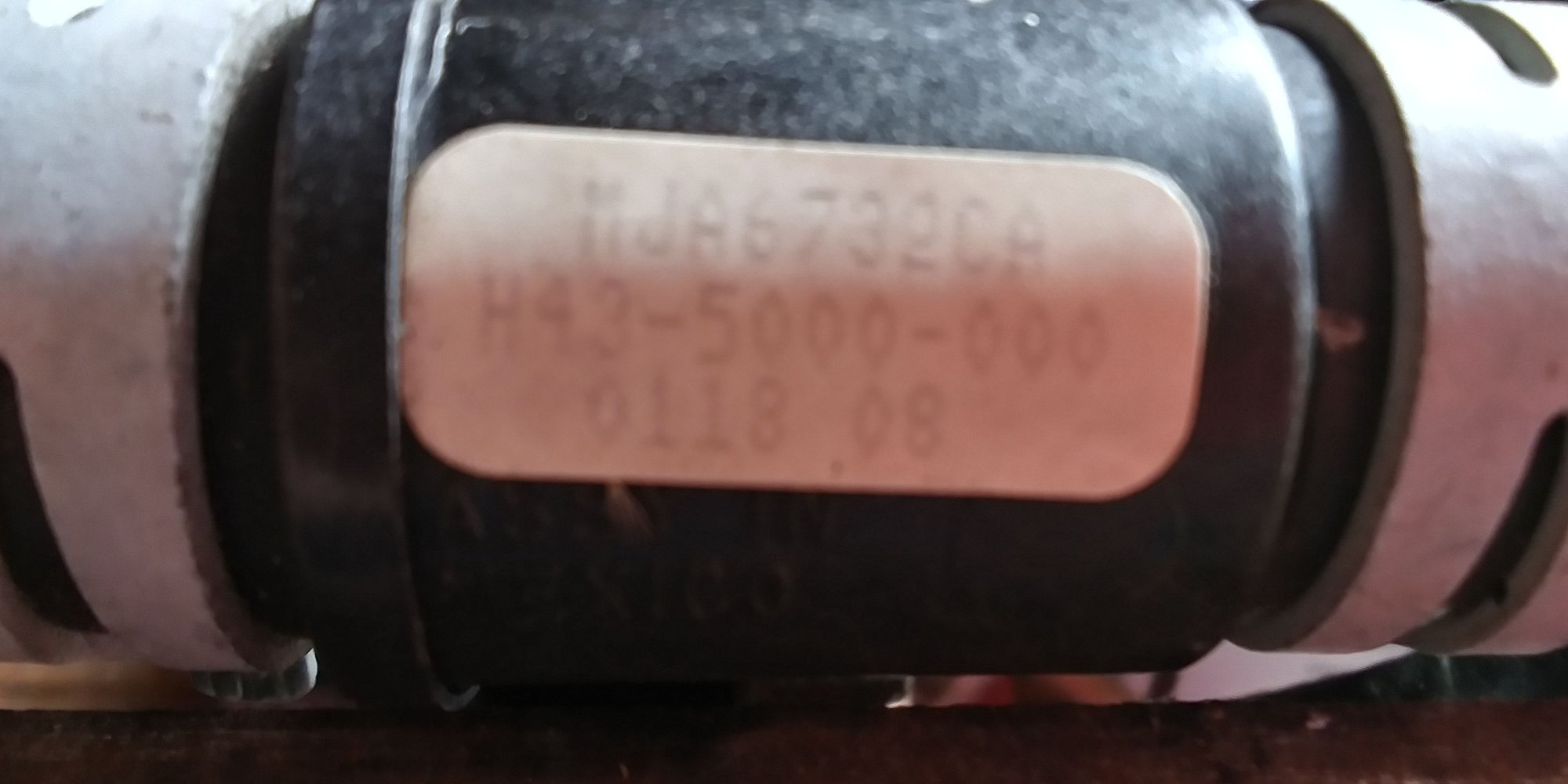

I checked the backflow preventer valve on the spider/octopus hose & the aux heater hose to the heater core & they are the same. I haven't checked if the part is available by itself but you can read the number off the images and search for it.
Spicer Hose Valve
Heater Core Valve
So it is available separately. Heritage carries it:
https://parts.jaguarlandroverclassic...urn-valve.html
Thanks for the part #. Not cheap, mind...

Wanted to close out my side of this thread. One-Way valve replaced thanks to RJ's kind assistance with a part donation.
Part# MJA6732CA still available at Terry's Jag (today is July 2021).
Same 1 way valve used elsewhere in the heater hoses.
In a jam? Need to temp it? The valve is 3/4 inch outside diameter. Pick up a 3 inch pipe from local plumbing store.
Hose clamp Notes: you will have to open (IOW squeeze the tabs together ALL the WAY!) the clamp as much as possible to get it back over the hose! I got them off with a hose clamp tool, but given (a) the working space; (b) the need to open the clamp 100%; i found it was much easier to use lock jaw pliers to reassemble.
The coolant flows starboard to port. There is an arrow on the valve. Odds you'll see the arrow before removal? About zero . . . :-)
