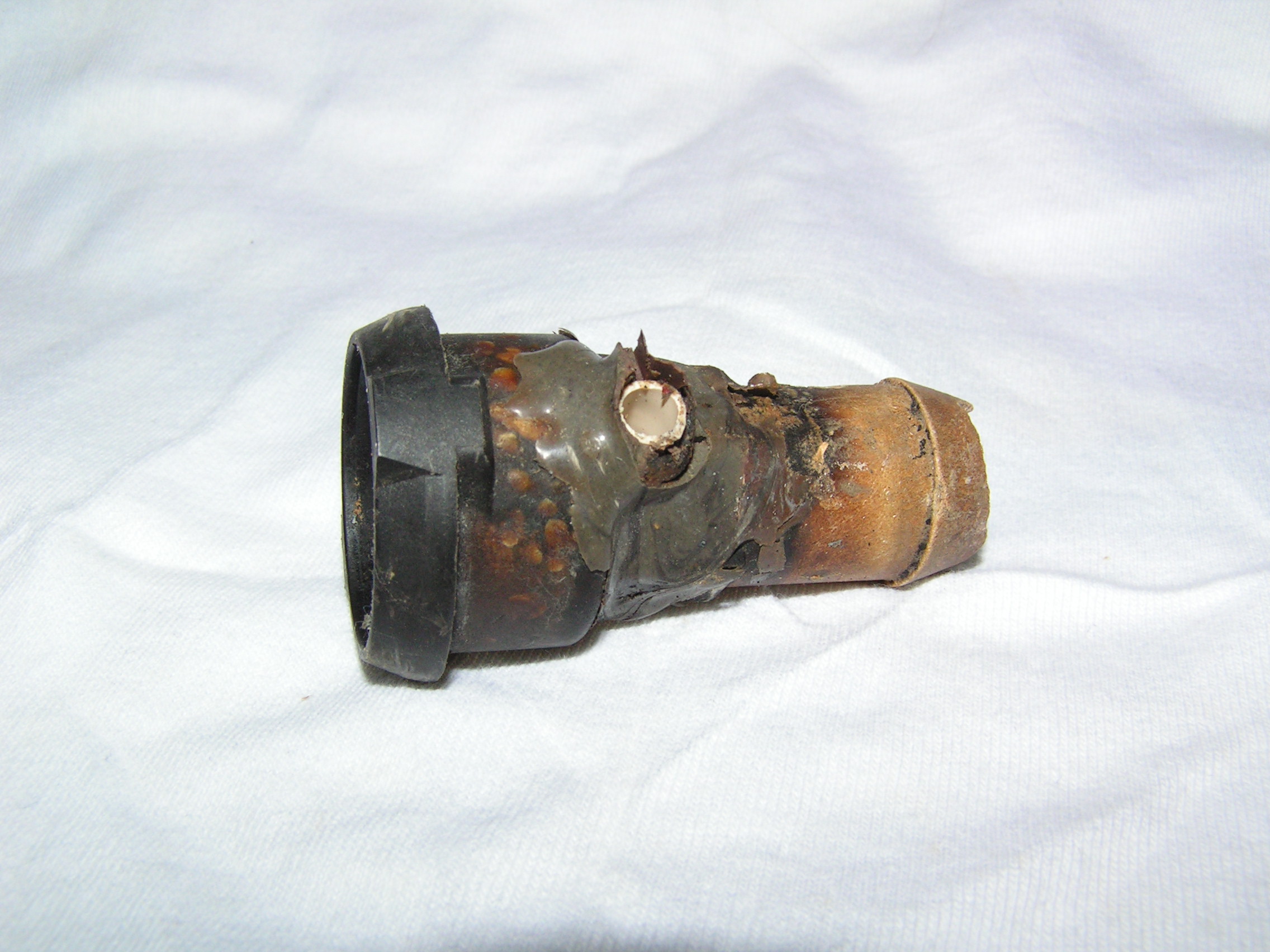

Shortly after replacing the timing chains, et al, a coolant leak became evident. At first, I thought it was the octopus hose. A close look revealed the leak was in a three way (octopus hose to the heater hose from under the intake manifold and to the throttle body) connecter somewhat under the throttle body.
After taking off the expansion tank, getting the clamps off presented the biggest PIA. I could barely get the pliers on the claims with various sharp edges from the mounting brackets digging into my arm. Getting the NORMA connector off, using 2 screwdrivers was actually easier. The part was all of $5.40, and reinstalling it went rather smoothly using screw clamps. From the picture, you can see that this connector had been previously repaired. The nipple for the hose going to the throttle body had apparently broken off, and another length of plastic glued into place. I managed to get the job done without removing the throttle body, but the sharp edges really dug into my hands and arms in the process.
