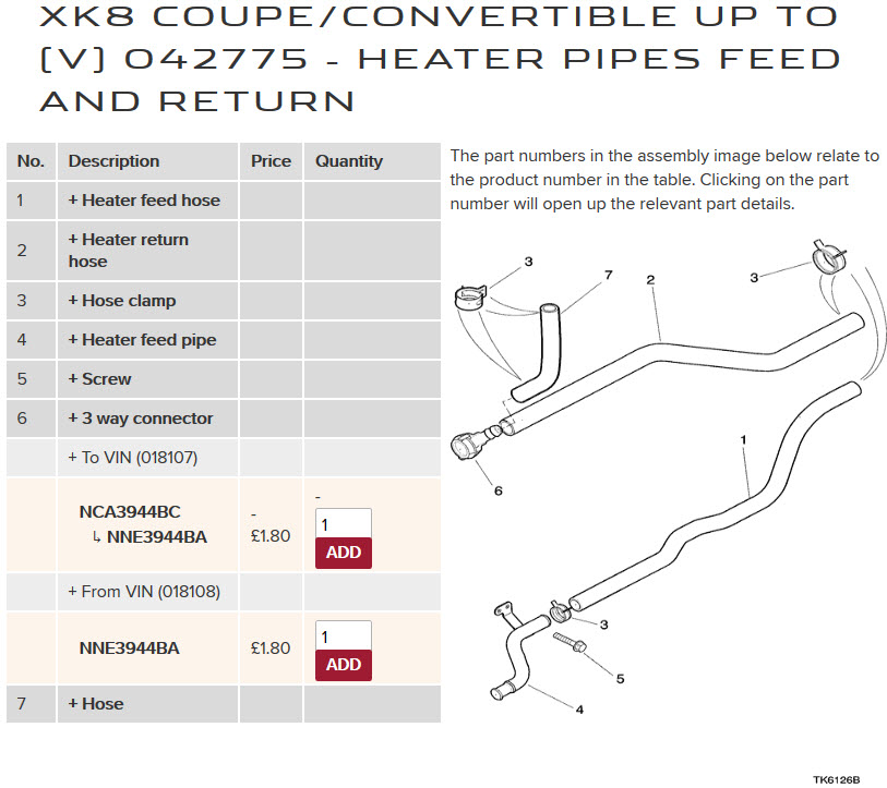

When it's leaking from where you pointed it out in the picture, it's the 3-way connector of the heater return hose (which is one of the valley hoses).
For detailed info see attached picture.
The connector is made of plastic and can get brittle with age, since it's positioned right above the LH cat. When changing it, I'd definitely recommend changing the two heater hoses (return and feed = valley hoses) as well as it is likely that they'll - sooner or later - fail too. Because of their location right on top of the hot engine block, they're prone to fail when ageing.
And as they're not expensive (<20 € in Europe), it's not worth taking the risk as soon as you're observing other parts of the coolant system deteriorating.
