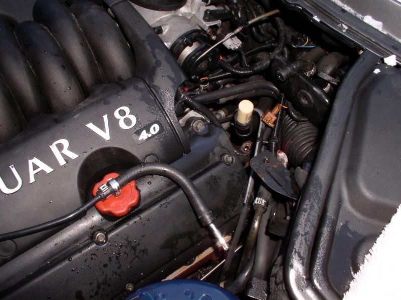

It's a very short length of cable branching from the harness to the brown connector:
Is the harness snagged?

The way the sensor has to fit in the tank the forward about 45 degrees to the left. It won't fit any other way. And the cable lookd like it was intended for it to point aft. The cable is not fouled that I can see

Looking at your picture that looks like the same length. But the sensor points forward and 45 deg off to the right. The two just don't fit.
