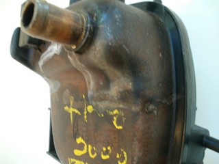

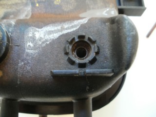

Default My apologies to JBWeld
My apologizes to JB Weld.
In a post above I assumed that the year old JB Weld repair to the coolant tank was the reason that I now had a leak. The old repair held perfectly, the NEW leak was at a totally NEW point.
After installing my new 'came in a Jaguar box' tank I took a couple pictures to describe the discussion in this thread.
The sensor is held in by 'plastic finger' without any seal. The sensor is isolated from the tank coolant. If you were to remove the sensor entirely there should be no leak unless the tank just decided to leak there.
The sensor is removed by gentle pressure to 'snap' it out of place. Very difficult to do without removing the tank.
The sensor tube is a single sheet of kraft paper soaked in epoxy protecting a glass enclosed micro switch. VERY fragile!
The year old JB Weld repair to tank was not the source of the leak. It was clean and dry.
A completely new spot, near the bottom hose nipple just decided to start leaking.
The new tank came with the sensor and pressure cap installed. The sensor still was held in place by the 'plastic fingers' but the Jaguar vendor had sprayed an adhesive on the connection that will make future removal difficult.
The old tank is toast but the sensor is fine. Free to anyone that has a confirmed sensor failure.
. . . and, yes, I had replaced the original tank with a wreaking yard one a year ago. It came with the leak that I fixed with the JB Weld.
Tight Wad Tom
