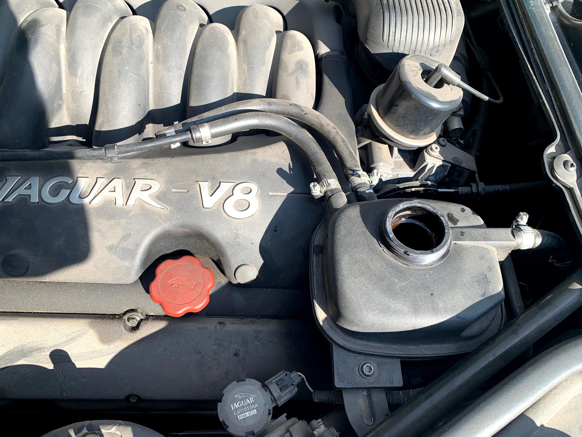

It sounds like you have a couple of issues so lets start with the coolant loss first. It sound as though you have had a lot of repairs done and it is possible that the hoses to the coolant tank are not installed correctly. Follow the link below and scroll to post #7 not the way the coolant hoses are installed. If one does not cross over the other then change the way they are installed.

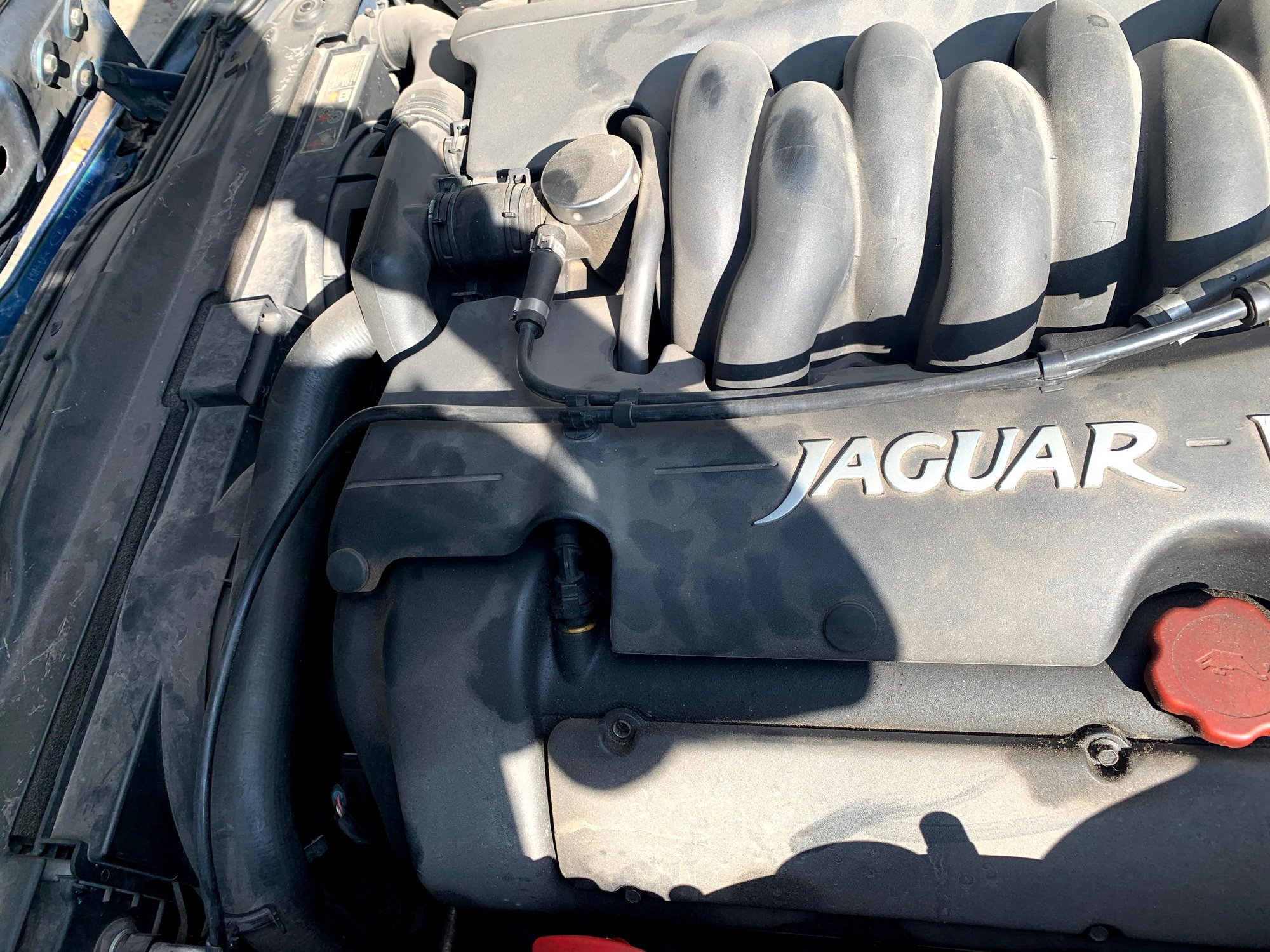

The Atmospheric Recovery Bottle is inside the rear the front wing (arrowed in red) but the overflow outlet (arrowed in green) exits close to the suspension.
If it is filling and overflowing, there must be considerable excessive pressure in the system. A faulty Expansion Tank Cap will relieve this causing coolant to pass into the Atmospheric Recovery Bottle but there must be another reason for the random and excess pressure. I would test the thermostat for correct opening/closing.

4. I don't have the expansion tank from the picture that avern1 directed me to - I'm guessing the image is from a more modern XK - I have the 'old style' one and it looks to me like the hoses are connected all correctly - the back one goes to the recovery bottle, and the front pair go to the thermostat and the radiator (in that order rear to front )
